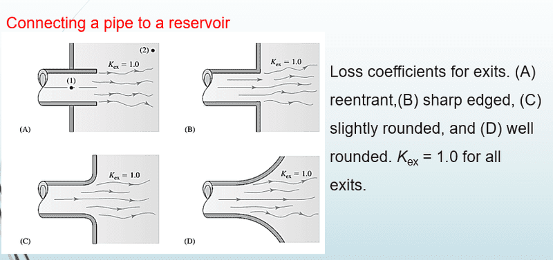

I know that when the fluid flow from pipe to reservoir, the coefficient of discahrge is 1, where head loss =k(v^2)/2g... How about the fluid is discharged from pipe to atmosphere??
IMO , it is still 1 for the coefficient of loss from the pipe to atmosphere , is it true , can someone clarify??
  • Four diagrams of a pipe exiting into a reservoir, labelled A to D: reentrant, sharp edged, slightly rounded and well rounded, each with Kex = 1.0 and streamlines in the flow.
i think there is no need to include the loss due to the fluid friction loss from pipe to atmosphere... i am not really sure thoigh
