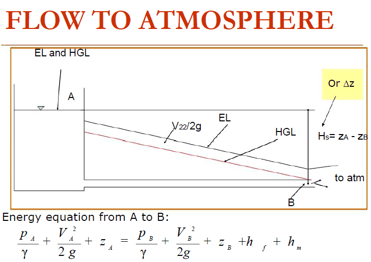

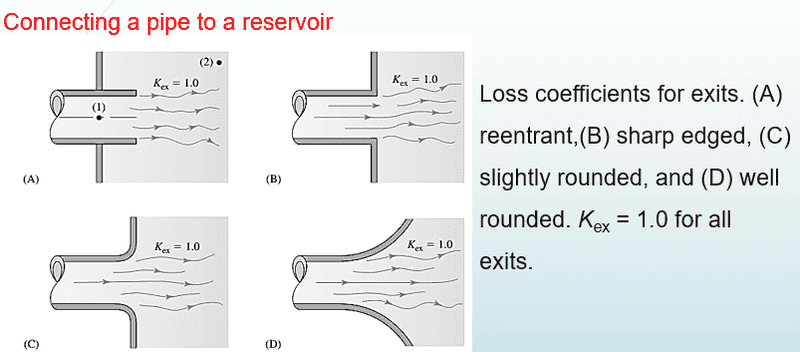

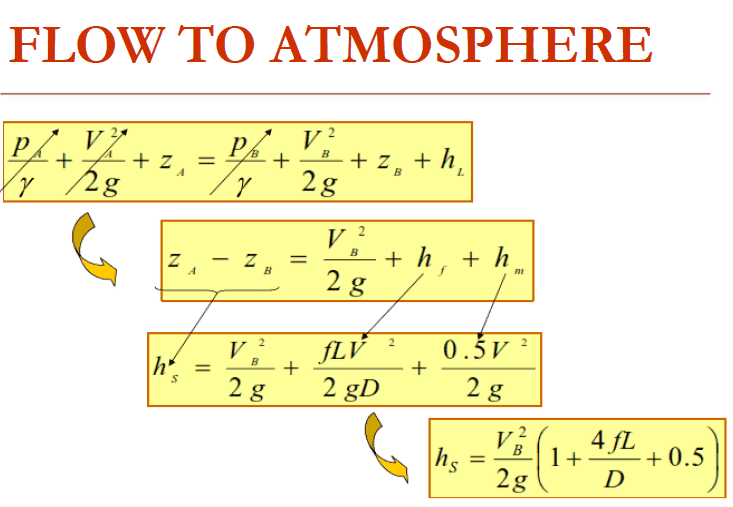

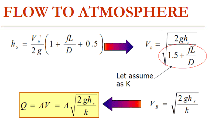

we know that the formula of head loss is k(V^2) /2g , the k = 1 when the water is discharged from pipe to reservoir ...However , how if the water from pipe is released into atmosphere ? is it necessary to include the head loss due to exit ? if so , is the k still =1 ? in the example , the author take k=1 when water is released to atmosphere from pipe , is he correct ?

I see no reason why k should be anything but 1 here. k not equal to 1 represents losses caused by messy flows at the junction. On egress to a wide reservoir or to atmosphere, there is no reason to suppose any eddy currents.
