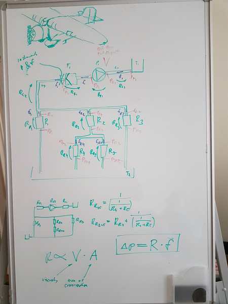

Hello folks,
sorry for the late reply. In all honesty I was a bit discouraged from your last response. I was initially hoping to find a simple, modular, out-of-the-box solution. Since there's no such thing, I decided to focus on something else in the meantime. But it's time to get back to my oil system and I did think a lot about it and would love to hear what you think about my thoughts.
First off, my knowledge of fluid dynamics is somewhat limited, however I feel very comfortable in the realm of electrics/electronics. From what I understand, this problem is very much like an electrical circuit. Is it fair to assume that similar correlations can be drawn?
I did draw the mesh of the oil system (Sorry for my bad penmanship:biggrin:):
Hand-drawn whiteboard sketch of an engine oil system: a tank, pump, filter and oil lines leading through resistance elements R1 to R5 to a sump, with a parallel resistance network and formulas for R and delta-p.
I identified the following components, starting top right:
The oil tank T1 connects though oil line L1 first to the oil pump P1 and then to the filter/screen. Oil line L2 gets the oil to the engine, and there are five components R1-R5 before the oil gets collected in the sump T2.
The red spots mark the different pressure points and blue is the oil flow.
I skipped the return path, since it's more or less independent from the oil flow through the engine.
I did the calculation for the viscosity, based on oil grade and temperature.
The way I would approach this problem in electronics is to calculate the "resistance" in each component as a division of viscosity and the area cross-section of the component (something like: R=VI/A). I can then substitute the complex mesh with simpler ones with this:
Rtot=R1+R2 for serial connections and 1/Rtot = 1/(R1+R2) in parallel connections.
The oil pump can be either be seen as a PRESSURE generator.
This is where the analogy to the electrical mesh ends though, since in electrical systems you always have closed circuits in which the sum of all voltages equals zero. In the case of my oil system I end up with a mesh consisting of a tank, a pump, a "resistor" and the sump. The flow rate must then be calculated from the pressure generated by the pump against the total resistance.
So here are my updated questions:
1. Are my assumptions more or less correct? If so:
2. What physical property is the "resistance" and what governing formulas exist for them?
3. What would be a formula for my last step? I.e. How do I calculate my flow rate in this simplified mesh?
Thanks for you patient, you have been a great help!

The analogy of an electrical circuit is a good start to working out the diagram. But it gets more complex very quickly because the resistance to fluid flow through an orifice is not linear like a resistor.
https://en.wikipedia.org/wiki/Hydraulic_analogy
The use of fluid lines are more critical with hydraulic systems than are wires with resistors. Hydraulic lines behave more like electrical transmission lines.
The analogy of the return circuit is present in fluid flow, the many returns to the tank or sump is the equivalent of the common ground or Earth connection.
You must decide when a fluid flow switches from a laminar flow model to a turbulent flow model. The following is essential reading. https://en.wikipedia.org/wiki/Darcy–Weisbach_equation
I do not think you can proceed without some graphs of flow versus pressure for the components of your system. You might compute those initial relationships, but I would be happier to experiment with hydraulic oil, differential pressure gauges and an accurate variable flow pump. I have a couple of tonnes of parts that I play / experiment with. That way I know what is real.
Maybe you could adapt an experimental motor to have multiple lubrication flow and pressure test ports.

I'd love to run those experiments, but the engine I try to simulate would set me back about 8000 Euros. I have to resort to assumptions and estimations for my parameters.
It's a continuous real-time simulation and it's not so much about the precision. If my simulation has the ballpark figures right, I'm happy enough. The main goal is to be able to simulate a realistic response to different boundary conditions. For instance I want to see a high oil pressure when the engine is starting at -20 degrees. Or a drop in pressure if a pipe starts leaking. Ultimately I want to come up with the formulas for the entire oil system first and then fine tune the parameters of each module by trial and error until I get a model that more or less reflects a realistic behaviour. So, the parameters don't really matter as much, what's important is to get the correlations right! Also, I want to limit the calculations to laminar flow only.
I skipped the return flow above, simply because it is completely detached from the rest of the mesh. That is because in this case the oil tank and the sump are two separate components. The oil drips and squirts into the sump, which acts as a reservoir. From there a secondary pump is pumping the oil back into the main tank.
OK, from what I'm getting, this is the course of action:
1. Calculate the energy that the pump is putting into the system - the energy is a function of the RPM of the engine and factors such as the efficiency.
2. Calculate the pressure loss for each component using Darcy-Weisbach with viscosity, pressure and geometry as input values.
3. Sum up the pressure loss in the entire system
4. Calculate the pressure of the pump as a function of the pump's energy and the pressure loss of the components.
5. Calculate the oil flow as a function of the pump's pressure, it's energy and the oil's viscosity.
6. Calculate the oil flow and pressure of each component
7. Rinse and repeat.
Does this sound about right?
That sounds like a good plan.
Don't forget the oil pressure relief valve and the backflow leakage of the pump. The oil grade, age and temperature will give a wide range of viscosity, so you must select and compute maximum and minimum viscosity values for the model.
How will you model a blocked oil filter with cold oil, does the filter have an internal bypass valve?

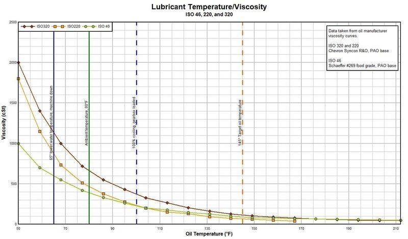

Oh man, that's interesting! We are talking about a gear pump here. The thing I'm wondering is how reliant the "constant flow" is when you operate it outside the norm. Let's say you're starting the cold engine at -20 degrees and your oil is already a bit old (Mind you: mineral oil, no additives!). I'd say there are two things that could happen: If the oil pump really displaces oil at a constant rate (only proportional to the rpm) the pressure would just build up until the bypass valves up. I could also imagine that oil that sluggish won't be displaced by the pump anymore, since it's not really liquid anymore. In this case the gears of the pump would simply rotate the same chunk of oil-goo round-and-round. So, the oil pressure would stay rather low, while your engine is slowly grinding down every single moving part until it breaks. :biggrin:
Also consider the opposite case: if your engine is running extremely hot so that the viscosity of the oil is waaaaaay below the normal operating range, the gears of the pump can't "grab" the oil anymore. It's just too thin. In this case the oil pressure again would be rather low with even worse results (since the engine is already running hot).
This is why I was thinking of having the pump produce pressure, rather than flow. But I'm happy to hear a counter-argument.

GMVitus said:
The thing I'm wondering is how reliant the "constant flow" is when you operate it outside the norm ... I'd say there are two things that could happen: If the oil pump really displaces oil at a constant rate (only proportional to the rpm) the pressure would just build up until the bypass valves up. I could also imagine that oil that sluggish won't be displaced by the pump anymore, since it's not really liquid anymore. In this case the gears of the pump would simply rotate the same chunk of oil-goo round-and-round.
In a positive displacement pump such as a gear pump, whatever makes it into the pump must come out the other side (minus back flow past gear tip and face clearances as @Baluncore pointed out, as well as side plate clearances). Very cold, highly viscous oil may not flow into the gear mesh at all, or at a rate lower than what the pump tries to take away (in which case the pump cavitates).
Unlike a centrifugal pump, oil within a gear pump cannot run around in circles - it shows up at the outlet, flows through the clearances, or develops enough force to blow the seals or break something else. Clearance back flow is viscosity dependent, and is lower for cold, high viscosity oil than when oil is hot and thinned out.
If it enters the suction port that hot oil is going somewhere. Very hot oil has an easier time of it going past clearances than when at normal operating temperature, but (unless the pump is badly worn) most of it still shows up at the pump outlet. Most of my oil gear pump experience was with force lubricated industrial gearboxes, and the following chart isn't directly applicable, but my suspicion is engine mineral oil viscosity curves flatten out in a similar manner as temperature rises as do these for PAO synthetic oil.
