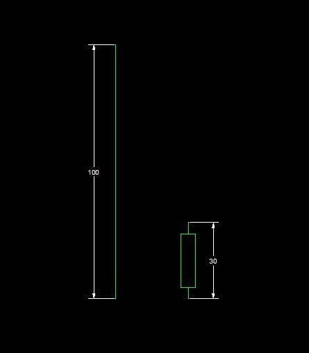

the straight and coiled pipe are vertical with the coiled pipe wound around a vertical cylinder. the 2 pipes when straight are of equal length but the coiled pipe appears shorter due to being wound around the vertical cylinder

there is an experiment I have to design to test the difference in flow rate in a tube of 3mm internal diameter of 100cm length where initial pressure is 300mmHg
the second pipe I would coil over a 10cm diameter cylinder shortening the initial length from 100cm to 30cm. all other properties kept the same

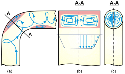

This article may be of help:
https://www.thermopedia.com/content/577/
Single-Phase Flow​
The main feature of flow through a bend is the presence of a radial pressure gradient created by the centrifugal force acting on the fluid. Because of this, the fluid at the center of the pipe moves towards the outer side and comes back along the wall towards the inner side. This creates a double spiral flow field shown schematically in Figure 1. If the bend curvature is strong enough, the adverse pressure gradient near the outer wall in the bend and near the inner wall just after the bend may lead to flow separation at these points, giving rise to a large increase in pressure losses. Even for fairly large-radius bends, the flow field in the bend will be severely distorted as illustrated by the data of Rowe (1970) shown in Figure 2.
The pressure losses suffered in a bend are caused by both friction and momentum exchanges resulting from a change in the direction of flow. Both these factors depend on the bend angle, the curvature ratio and the Reynolds Number. The overall pressure drop can be expressed as the sum of two components: 1) that resulting from friction in a straight pipe of equivalent length which depends mainly on the Reynolds number (and the pipe roughness); and 2) that resulting from losses due to change of direction, normally expressed in terms of a bend-loss coefficient, which depends mainly on the curvature ratio and the bend angle. The pressure loss in a bend can thus be calculated as:

Locating both pipes in a vertical position will create the problem of different heights (and hydrostatic pressures) for outlet and inlet for both.
100 - 30 = 70 cm or 0.7 m column of water, which is a pressure difference of 6865 Pascals.
That pressure differential will be a 17.1% of the input pressure, which will be 39997 Pascals (300 mm Hg).

why would the column of water differ, they will both contain the same amount, as they are both 100cm length except one is coiled in the middle so that the new measured length from its inlet to outlet is 30cm
Same volume of water, same length of pipe.
Reply
The hydrostatic head only depends on the difference in elevation between two points.
