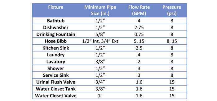

For a normal family home in USA, the diameter of the pipe connecting it to the city main via water meter is 1-inch or 3/4-inch.

Mainly as a reference about typical pipe's diameters and water supply flows in a family home.
