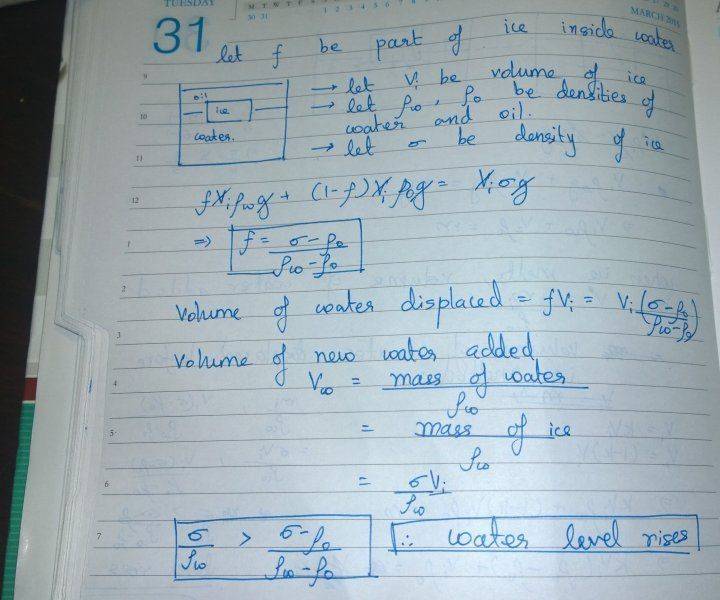

A cube of ice is floating in water such that some part of the ice is submerged. Oil is poured on the water.( so water on the bottom, oil on top and ice in between). When the ice melts completely, the level of oil-water interface ______(rises/falls) and the top level of oil ______(rises/falls)
None.
The water level goes up a bit due to the ice cube. Also, the level of oil will also be higher than usual since the ice occupies a part of its volume.
Now, as the ice starts melting,
1)the volume of water increases but the level of water has a tendency to fall as volume of water displaced by ice decreases. <---- But I am not able to draw a conclusion here.
2)the top level of oil has a tendency to fall since the volume of oil displaced by ice decreases. And the the net increase or decrease in level of oil depends on the level of water. <---- I need to know case (1) to answer this.
(answer given: Rises,falls)

Yes,so if you add oil, what happens to the volume of water displaced by the ice cube.

Sure. Let the side of the cube be s, and let f be the fraction of the cube volume above the liquid water surface. In terms of s and f, what is the volume of oil displaced? What is the volume of liquid water displaced? What is the buoyant force on the cube? From a force balance on the cube, what is f equal to?

Volume of cube in water = ##(1-f)s^3##
volume of cube in oil = ##fs^3##
Buoyant force due to water = ##(1-f)s^3\sigma_1g##
Buoyant force due to oil =##fs^3\sigma_2g##

Right, so what equation relates those to the weight of the cube?

$$(1-f)s^3\sigma_1g+fs^3\sigma_2g=s^3\rho g$$

OK. So now solve this equation for f. How does this solution compare with the value of f you get when there is no oil on top of the water?

$$f=\frac{\sigma_1-\rho}{\sigma_1-\sigma_2}$$ when oil is present
Taking similar situation with f part inside water,
$$f=\frac{\rho}{\sigma_1}$$
In presence of oil, the buoyant force is increased due to buoyant force by oil.
So with oil, the part inside water is lesser.

Actually, to be clear, your first equation for f is the part outside the water, and your second equation for f is the part inside the water.

So, what does this mean with respect to what happens when the ice cube melts? How does the cube melting affect the depth of the water layer?

As the ice melts, the volume of water increases, which tends to increase water level and the weight of ice decreases which tends to decrease the water level. But how do I calculate the net effect?

What is the volume of ice below the water surface before the ice melts (in terms of s)? What is the total volume of water that forms when the ice cube melts (in terms of s)? What is the difference between these two volumes?

You already determined that, before the ice melts, the fraction of ice under the water surface is ##\left(\frac{ρ-σ_2}{σ_1-σ_2}\right)##. So the volume of the ice cube below the water surface before it melts is ##\left(\frac{ρ-σ_2}{σ_1-σ_2}\right)s^3##. The volume of water that forms after the ice cube melts is ##\frac{ρ}{σ_1}s^3##. Part of this melted volume of water goes into filling the void left by the part of the ice cube that was below the water surface. The rest of this volume adds to the depth of the water layer (if there actually is any left over). So from these relationships, is there any left over, and, if so, how much?

Water level does not change.
##mg=V_i\rho_wg##
##V_i=m/\rho_w##
When ice melts, the volume of water formed is same. So no change.

That's only if these is no oil present.

Finally... Water level rises when oil is present.
