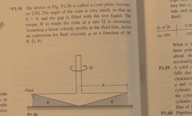

τ =μ (du/dy)
I got far enough to write down
dM = μ (Ωr/tanθ) dA
from just substitutions, easy enough.
I get confused when I'm solving for the differential surface area. I somehow need the dA for a cone.
For a circle it's easy enough. A=πr^2 so then dA = 2πr dr.
But how do I go about getting this for a cone? the book lists it as (2πr/cosθ) dr, without any explanation, of course.

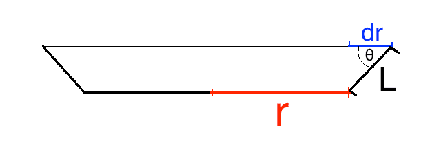

Take a strip element 2πxdr, where x is the radius of circle formed by that strip element. Try relating x to r using similarity of triangles.
Well you should first understand how to find the surface area of a "truncated cone" (ignoring the faces)
It is the average circumference of the cone multiplied by the side length (not the height)
So the surface area of a truncated cone (ignoring the faces) is [itex]2\pi r_{avg}L[/itex] or you could say [itex]2\pi L\frac{r_1+r_2}{2}[/itex]
(Side note, this also applies to normal cones; just treat the tip as r2=0)
So with this understanding of truncated cones, look at the following picture I made:
The differential surface area would be [itex]2\pi r_{avg}L[/itex] but as you can see from the picture, [itex]L=\frac{dr}{\cos\theta}[/itex] therefore the differential surface area is [itex]\frac{2\pi R_{avg}}{\cos\theta}dr[/itex]
The two radii are r and (r+dr) but since dr is obviously infinitesimal, it suffices to say [itex]r_{avg}=r[/itex]

No that is incorrect. The differential area element is [itex]\frac{2\pi x}{\cos\theta}dx[/itex]
Me and the OP were using r not to represent the radius of the base of the cone, but to represent what you called "x"

Excellent explanation. Thank you very much, Sir.
