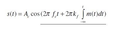

Hey guys, I'm trying to understand the complex envelope of a Frequency Modulated signal. According to the Textbook by Leon Couch, the complex envelope of an FM signal, g(t) modulated by the signal m(t) is given by:
g(t) = Ae[itex]^{jθ(t)}[/itex]
where
A = |m(t)|
and
θ(t) = D[itex]_{f}[/itex] [itex]\int[/itex][itex]^{t}_{-∞}[/itex] m(σ) dσ
Now if i want to determine the angle θ(t) of the complex envelope of the FM signal modulated by m(t) = Am cos (ωt)
i get:
θ(t) = D[itex]_{f}[/itex] [itex]\int[/itex][itex]^{t}_{-∞}[/itex] Am cos (ωσ) dσ
= D[itex]_{f}[/itex] Am [itex]\frac{sin(ωσ)}{ω}[/itex]|[itex]^{t}_{-∞}[/itex]
= D[itex]_{f}[/itex] Am ( [itex]\frac{sin(ωt)}{ω}[/itex] - [itex]\frac{sin(ω(-∞)}{ω}[/itex] ) This is where i get stuck. I'm not sure what to do with the -∞.
I though I knew how to deal with improper integrals, but I'm not sure where to go from here. Also I'm not sure why the lower limit of integration should be -∞, it seems to me like it should be zero? Any one know how I can resolve that integral? I would like to really understand this concept, but this part has me stuck.

Here is the equation for the FM complex envelope given by a tutorial from the Illinois Institute of Technology, also my textbook by Leon Couch uses an integral with the lower limit at negitive infinty. I did notice however that there are some tutorials that use 0 as the lower limit. Anyways, I'm not sure what to do with this.

I read the whole tutorial: it tries to keep things simple, which is a good (since it is just an introductory tutorial), but I think this may lead to some inconsistencies if you aren't careful. However, I noted a slightly abused notation; thus, let me restate things a bit.
Given the following signal: [itex]s(t) = A_c\cos(2\pi f_c t + \varphi(t))[/itex], you can define the so-called instantaneous phase [itex]\theta(t) \triangleq 2\pi f_c t + \varphi(t)[/itex], and the so-called instantaneous frequency [itex]f_i(t) = \frac{1}{2\pi} \frac{d}{dt} \theta(t)[/itex]. We know that in FM: [itex]k_fm(t)=\frac{1}{2\pi} \frac{d}{dt} \varphi(t)[/itex]. Now, if you try to solve this equation, giving an explicit expression of [itex]\varphi(t)[/itex], you end up with the integral you wrote. Usually, that integral goes from [itex]t_0[/itex] (which can be set equal to zero) to a generic [itex]t[/itex]. However, it isn't technically incorrect to say that it goes from [itex]-\infty[/itex] to [itex]t[/itex] if you let [itex]m(t)[/itex] be a causal signal, i.e. there must exist [itex]t_0[/itex] (which, again, can be zero) such as that [itex]m(t)=0 \ \ for \ \ t<t_0[/itex]. More precisely, the generic expression is: [tex]\varphi(t) = 2\pi k_f \int^t_{t_0} m(\tau) d\tau + \varphi_0[/tex] where [itex]\varphi_0 \triangleq \varphi(t_0)[/itex] is the initial phase (which is irrelevant and can be neglected). By choosing [itex]t_0=0[/itex] and [itex]\varphi_0=0[/itex], you obtain:
[tex]\varphi(t) = 2\pi k_f \int^t_0 m(\tau) d\tau[/tex] and this is the standard formula. If you (re)do all the computations with this formula, you can "forget" the fact that [itex]m(t)[/itex] must be causal, since the integration domain is now a finite time interval. However, if you want to keep using your notation, then you must write: [itex]m(t)=A_m cos(\omega t) u(t)[/itex], where u(t) is the unit step function (zero for t<0, 1 otherwise), where I assumed (for simplicity) [itex]t_0=0[/itex]. Hope this helps.

Thanks for your guy's explanations. If i can sum up what you said...
When we consider signals, m(t) that begin at time t=0 or t> 0, which are realizable signals, we evaluate the integral from the lower limit of 0?
That seems to make sense to me. Hope I understand it correctly.
Thanks.
So the integral with the lower limit of neg infinity, is a more general expression, that could include non causal signals?
