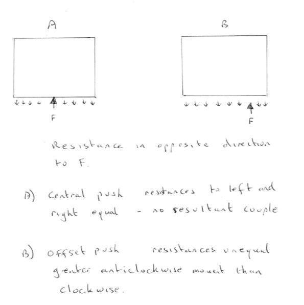

To understand how the turning couple arises (on Earth)
Place a book flat on a table with its spine towards you.
Since gravity is a right angles to the table top gravity does not affect this experiment.
No push the book away gently from you by pushing the spine with one finger in the middle of the book.
The book slides away over the table without rotation.
Now repeat moving the point of pushing with the finger a little towards one end of the book.
If you repeat this several times you will come to a point where the book rotates like your pencil as well as sliding forwards.
The closer to one end you push the more rotation and the less translation you will note.
Why?
Well the distance from the push point to one end is equal to the distance from the push point to the other when you push in the middle.
If you imagine the resistance to motion distributed in little arrows all along the spine, the moment of that resistance force to the right of the push force is of the opposite direction to the moment generated by the push force to the left.
When the distance are not equal the moments are not equal. So the book rotates.
