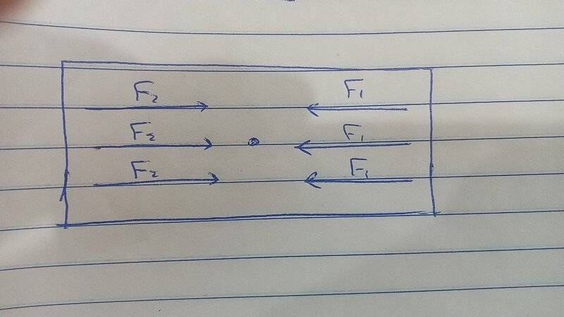

How about if we take the following scenario: a pool of water in which there are two opposite forces acting on each side of the pool towards the center -I think this will be more obvious if I uploaded a sketch- in this case the resultant force is zero on the fluid, but still the fluid is not in a state of equilibrium as I think.Now, I think the first two conditions of equilibrium in fluids (Newton's first and third law) are not enough, because of the previous scenario... I have two ideas but do not which one is more accurate.
1- We shall add the condition that the pressure is the same in all parts of the fluid.
2- We shall apply Newton's laws on each little segment of the fluid.
Which one is more accurate and why?

Arjan82 said:
Note that zero-torque is just an application of Newton's laws (specifically for rigid bodies), it by itself is not a new law. There is no equivalence in Fluid mechanics (i.e. in the Navier-Stokes equations, which is just Newton's second law applied to a fluid).
Since a vortex requires energy to make and even to keep on existing, the net force on the fluid that generates a vortex is not zero (also, it is of course not static).
- First, I have not said that zero-torque is a new law... it is just a condition for equilibrium in the case of rigid bodies.
- Second, I do not know what is the relation between energy and equilibrium, please may you explain to me further?
I didn't say you did. I just wanted you to note that since you were asking for an equivalence. Why would you ask for an equivalence if there is nothing to justify that?
You write that you've understood the net force on a vortex is zero. Zero force means zero energy added to the flow. This cannot hold since it requires a force to keep a vortex in existence.
Newton’s laws are not conditions for equilibrium. They also hold when things are not in equilibrium.
Well, but I still struggle to find a full list of conditions for equilibrium in fluids, which can satisfy any scenario I think about. Thus I am trying to find them... and I thought comparing the two situation is a good way to do this (or at least to help in doing this).
