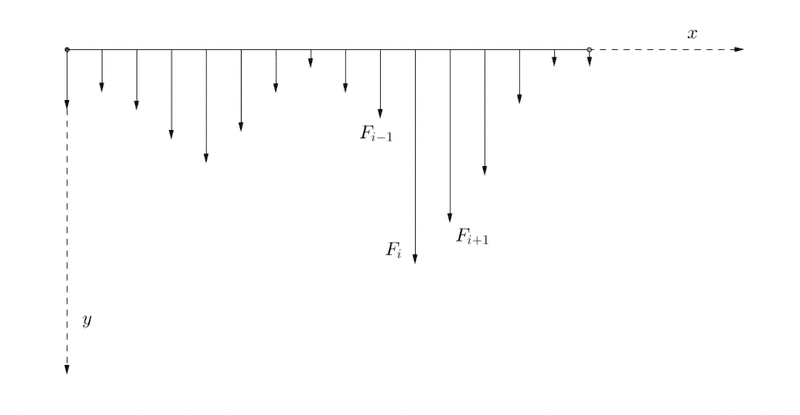

I attached a picture, just to make things a bit more clear.
At the picture I have drawn discrete forces ##F_i## and the condition says that $$\sum_{i=1}^NF_i=F_0.$$ In other words, what I did here in discrete case is that I have split the available force ##F_0## into ##N## forces that sum up to back to ##F_0##. But I don't want to work with discrete values, because it is unrealistic, I would like to find a continuous function that meets the same condition ( ##F_0##).
If it is possible. Anyway I am completely open to any other suggestions or any other ideas on how to solve this problem. It doesn't matter how I get it, in the end all I need is ##F(x)##, where ##F(x)## describes the amount of force (in Newtons) exerted on a rod at length ##x##.

I consider your scenario as really being a force-per-unit-length. In the discrete form you get discrete bits of force each discrete bit of length, but in the limit it becomes a continuous function.

yes, so this new f = F/L ... just like you said back in #14
skrat said:
Ok than, so following SammyS my condition than says $$\int _0 ^L f(x)dx=F_0$$ where ##f(x)=a\frac{F(x)}{L}## for ##L## being the total length of my rod, ##a## normalization constant and ##F(x)## actual force.
Right?
That's not how I'd put it.
In the discrete view, you have forces Fi, i=0...n, at regular intervals S, nS=L.
Suppose we now double n and halve S. We have to fill in extra forces. To get the same total, we must roughly halve each existing force and fill in new forces halfway between them by, say, taking the average of two neighbours. This keeps the total about constant, and also the local force per unit length: half the force at half the distance.
Repeating this process, in the limit you have a smooth curve f(x). At an original point i, x=iS, f(x) ~ Fi/S.

Also repeating this process ##F_i\rightarrow 0##.
