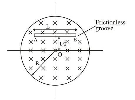

Uniform magnetic field ##= Bt## exist in cylindrical region of radius ##R## is pointing into the plane of figure (as shown in figure). A frictionless groove of length ##L## is fixed symmetrically from the centre O at a distance of ##\frac{L}{2}## .A charged particle of mass m and charge q is at rest at end B at ##t =0##. Neglect gravity and assume the particle just fits in the groove. Velocity of the particle at the end A is
Diagram of a circular region with crosses marking a uniform magnetic field pointing into the page; a horizontal frictionless groove AB of length L sits above the centre O, offset by L/2, and radius R is marked.
Time varying magnetic field will generate an induced emf and hence an electric field. A component of this field will accelerate the particle. Now I have the potential as ##\pi r^2B## where ##r## is the distance from the origin. Now I am having difficulties calculating the electric field. What would be it's direction? Would it be in a concentric circle like induced current? If so, would differentiating w.r.t. r be correct?(since r would not change as potential changes).

Sounds right to me. Can you figure out the potential between the two ends of the groove?
I don't really understand between which points exactly is the potential difference ##-\frac{d\phi}{dt}##. I can only think of it as the potential difference between the point and it's rotation by ##2\pi## radians, which seems nonsensical. But thinking about it this way I find that since the two points are at ##\frac{1}{4}## th rotation of a circle, the potential difference is ##\frac{1}{4} \pi Br^2## where ##r## is ##\frac{L}{\sqrt{2}}##.

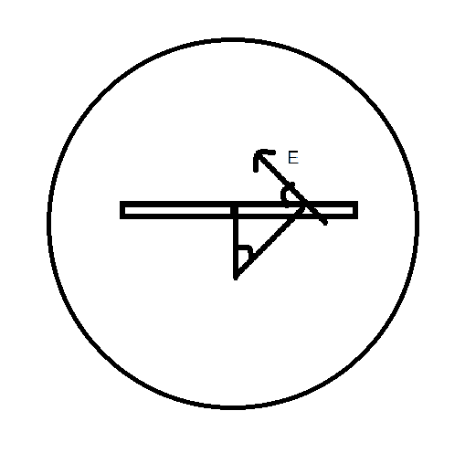

So ##\pi r^2 B ## is the potential difference when ##E## is integrated along a circular path. Assuming magnitude of E to be constant along the circular path ##2\pi r## times ##E## is ##\pi r^2 B##. So ##E## is ##\frac{r}{2}B##. Since you mentioned that the induced field is non-conservative, I guess the path does matter? So the potential difference between the two ends of the groove is
$$\Delta V = -\int_{-\frac{\pi}{4}}^{\frac{\pi}{4}} B\frac{L}{4} \sec(\phi) \cos(\phi) d\phi $$
Here I have written r in terms of ##\phi## which is the angle between the perpendicular bisector of the groove and the position vector. Only the ##\cos(\phi)## component of the Field is taken.
Diagram of a circular region with a horizontal bar across its centre, a dashed radius from the centre to a point on the bar, and an arrow labelled E at an angle to the radius.
From this ##\Delta V## is ##-\frac{\pi}{8}BL## which is very similar to the pot. difference I got in post#3 but seems dimensionally incorrect :frown:Also sorry for the late reply

You integrated ##E\cos\phi\,d\phi##, but you want to integrate ##E \cos\phi\,dx##. You need to write ##dx## in terms of ##d\phi##.

Anyway I too, noticed something. ##E \cos(\phi)##, where ##\phi## is the angle I marked in my Paint diagram/scribble but forgot to label. So there is a constant field acting on the particle, i.e. a constant force and hence constant acceleration. Using ##v^2 = 2as## I got the correct velocity. What I get when using the area as potential difference is very similar, leading me to believe that the potential is somehow "B" times the area?

Ahh thanks ! I knew something was wrong with my integral. But using ##x = \frac{L}{2} \sec\phi## and thus ##dx = \frac{L}{2}\sec \phi \tan \phi## would lead the integral being equal to ##-B\frac{L}{4} \sec \phi##. Putting in the limits I would get zero...
You mixed up ##r = \frac L2 \sec\theta## and ##x = \frac L2 \tan\theta##. But your observation earlier that the component of the electric field along that path is constant let's you say
$$\Delta V = -\int \vec{E}\cdot d\vec{r} = E_x \int dx = E_x L.$$
