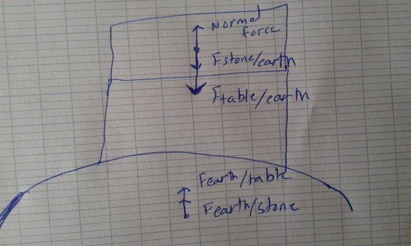

Ok,now let's take the approximated equation for which F=mg.
If we take the system as (earth+stone),the Earth will make a force F=mg on the stone and the stone will react by the same force but in opposite direction on the earth.
Now put the stone on a table(the system is now:earth+table+stone).Does this cancel the reaction force of the stone on earth?

Drakkith said:
Certainly (as long as 'cancel' means 'opposes')
I meant by "cancel" that the force will disappear temporarily until the table is removed,because if this doesn't happen the summation of the internal forces will not end up to zero and this is impossible according to Newton's third law.
How do you figure that?
As showed in the figure if you add the internal forces,all will be canceled except the normal force will remain.
[F earth/stone +F stone/earth +F earth/table +F table/earth +normal force of the table (due to the interaction with the stone)]is not equal to zero.
Orodruin said:
No, there is still a gravitational force on the Earth from the stone, it is a force pair with the gravitational force from the Earth on the stone, as required by the third law.
Yes, but this will lead that the summation of internal forces is not zero.
Let's call your "normal force" Fstone/table. By Newton's 3rd law, there is also an Ftable/stone which is equal in magnitude and opposite in direction.
YES, YOU ARE RIGHT!
I don't know how I missed it haha.
thanks all :biggrin:.
