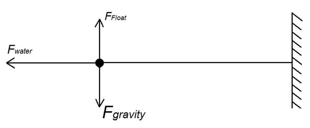

Hello there,
I was wondering, and i can't seem to really find the answer to my question, i found something that looks like it, but I am not sure if i understand correctly, that why I am turning to PF.com
1) What is the basic formula of the force on a object in flowing water when we assume that the object is tied to a point that is upstream. So the rope between the object and his anchorpoint upstream is always tight.
2) What is the influence of the shape of the object and the depth (surface increased) of the object in the water on the formula.
I assume that their are a couple factors:
-The surface of the object that is in the water
-The drag of the object (aerodynamica)
-The speed of the moving water
-anything else?
The reason i ask:
I want to calculate roughly how much power is needed to hold a ship on the same location (relative to the shore) when its pointed upstream. (and I am not yet taking the efficiency of the prop in account, let's say the efficiency is 100% at this time)

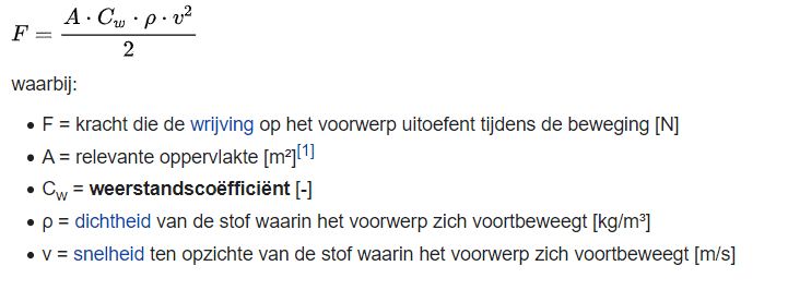

Thanks you! That was the word i was searching for. I adjusted it in the post
Okay, so i found this
Where A is the surface
Cw is dragcoefficient
p is density of the liquid
v is the speed
So with this formula i can calculate the friction between the water and the object in Newton.
But now i want to know how to calculate the power that is needed to maintain the objects position without the anchorpoint to the shore. I assume that the weight becomes a great factor now?
Power in this case should be ##Fv##. The mass of the object is not relevant (unless you want to accelerate it).

The general formula for the drag is a bit inaccurate for a ship. It only concerns the part of the resistance that scales with the dynamic pressure.
There are normally three components in ship resistance:
Frictional resistance.
Just the friciton of the water alongside the hull. Normally you can compute this with a surface which has the length of the ship, and a width that is chosen such that the surface area is equal to that of the submerged surface area of the ship. You then need a frictional line to relate the surface area, ship velocity, viscosity and density of the water (i.e. the Reynolds number) to an actual resistance, see here for example.
Viscosity induced pressure resistance.
This has to do with pressure recovery at the aft body of the ship. At the fore body a high pressure is generated because of the water hitting the bow. Then the pressure is lowered as the flow is accelerated alongside the ship hull. Then, it should be the case that the aft-body of the ship 'recovers' this pressure by increasing it again. This can be done by shaping the aft body gently such that the flow is slowly decelerated again without any separation. For potential flow theory the pressure recovery is always a 100%, but due to the formation of a boundary layer (a viscous effect) this is not true for real flows. This is why it is called viscosity induced.
Normally this is taken into account by a 'form factor' This is a number higher than 1, which is the increase in frictional resistance due to this viscosity induced pressure resistance. For a well designed ship this is in the order of 1.2 (so this resistance is about 20% of the frictional resistance). But actually this is very dependent on the quality of the hull shape.
Wave resistance.
This is the resistance that is due to the fact that a ship makes waves. Generating a wave costs energy, which results in extra drag. There is no easy formula for the wave resistance but it depends on the Froude number. A Froude number below 0.5 means you have a 'displacement ship' for which frictional resistance is often dominant, between 0.5 to 1.0 is a semi-planing ship for which wave making resistance becomes most important and Froude > 1.0 means the ship hull is lifted from the water. Wave making is very important here as well. For displacement ships you can use this formula:
as explained here. This is a semi-emperical formula based on many tests and statistics. It is only valid for certain types of ships.
The weight of the ship is an important parameter for the resistance of the ship, but only indirectly. The weight must of course be compensated with the buoyancy. The buoyance is directly related to the volume of water that is displaced. That on its turn is related to the surface area and thus to friction. But a bigger displaced volume also means a higher wave resistance.
