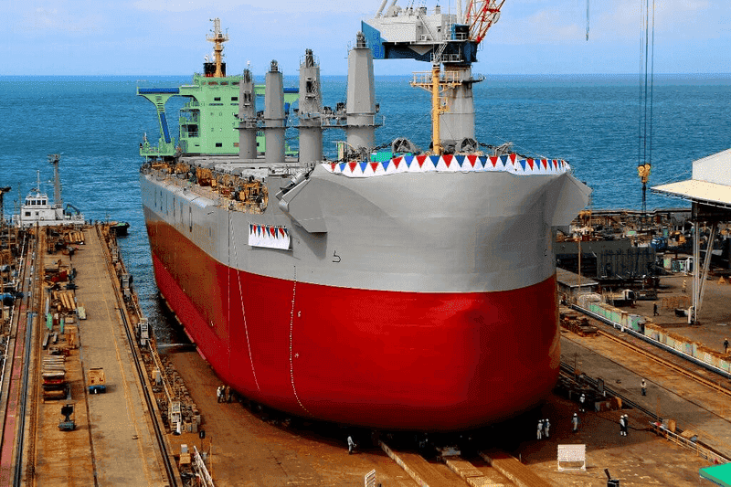

There is no such thing as a boat "on the water". A portion is always below the water. The part below the water moves aside some water to make room. Magically, the weight of the water moved aside equals the weight of the boat. That is called https://en.wikipedia.org/wiki/Archimedes'_principle
When this ship is on the water, the red part goes under the water.
