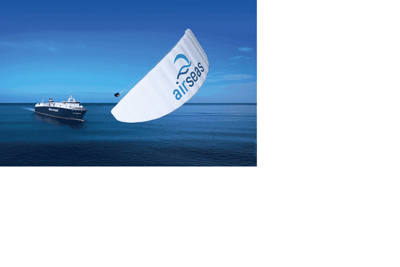

If you use the drag of the kite for propulsion you're doing it wrong ;). The lift is much higher than the drag and the lift vector of the kite should have a significant component in the horizontal direction (and of course as much as possible in the forward direction). So you should optimize the lift over drag ratio and get a high as possible/practical amount of lift.
So something like this:
The advertising information for the kite in question indicates that they do just this. The kite is flown back and forth in a figure eight pattern at high speed (100 kph) so that it is primarily lift that tensions the cable rather than drag.
The claim is that this increases the "effective area" of the kite by a significant factor. Much like three bladed wind turbines effectively harvest wind energy from a region larger than just the area of the blades.
As in all pictures I've seen, the ship has a tailwind, the kite is flying dead ahead. There is no tacking going on. The hull is not being called upon to act as a water foil. There is no yaw torque to interfere with steering.
jbriggs444 said:
As in all pictures I've seen, the ship has a tailwind, the kite is flying dead ahead. There is no tacking going on. The hull is not being called upon to act as a water foil. Nor is there any yaw torque to interfere with steering.
Actually, the kite in the picture does not have tailwind but the wind is somewhat from the side. This means the angle of attack of the wind on the kite is from the side such that it can generate a forward lift. Otherwise it would have to rely solely on its drag resistance, which generates a much lower force (and you can never sail faster than the wind for it to generate a forward force)
That however doesn't dismiss your other conclusions. There is definitely no tacking going on, much too difficult for such a ship (and prohibitively increases time and costs due to the longer path taken).
Based on the waves, the absolute wind appears to be about twenty, maybe thirty degrees port of directly astern. Call it a quartering tailwind if you like.
If the absolute wind was from directly to port, a kite flying directly ahead of the ship would have zero lift and would be falling into the sea.
But yes, certainly a kite can fly directly ahead in a relative wind that is coming from a direction somewhat aft of directly abeam.
Ok, that's what I meant by 'somewhat from the side'... I didn't mean exactly 90 degrees. Sorry for being so wooly :).
But this picture is also fake (intended for commerce), I don't think the kite is effective for tailwind.
