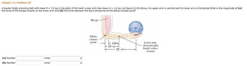

T=rF
I'm not sure at all how to solve this problem. If anyone can help me out with setting this up and proceeding from there that would be a big help.

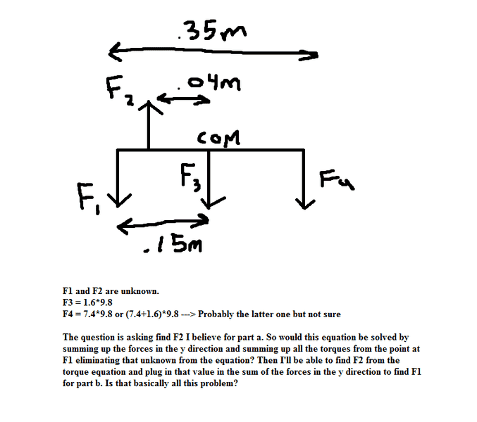

start with a free body diagram of the lower arm showing all forces and reactions, then balance forces and moments
Is that free body diagram correct and what would the force be on F4? And is my method for part a and b correct?
Anyone know if the above is right?
