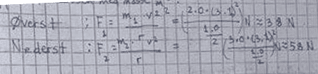

A carbon fiber rod of length L = 1.0 m and of negligible mass can rotate without
friction about an axis through its midpoint. Two small blocks of lead with masses m1 = 2.0 kg
and m2 = 3.0 kg are attached to each end of the rod. You hold the bar in a horizontal position and
release the system.
What is the speed of the blocks when the rod reaches a vertical position? You can disregard
the air resistance.
How great are the forces in the rod when it is vertical and in which directions do they act?
How big is the force on the axis, and in which direction does it act when the rod is vertical?
Ep=mgh, Ek=1/2mv^2, a=mv^2/r
I get that the speed is 3.1 m/s, the forces in the rod are 38 N downward and 58 N upward, and that the force on the axis is 49 N.

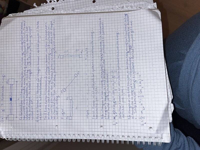

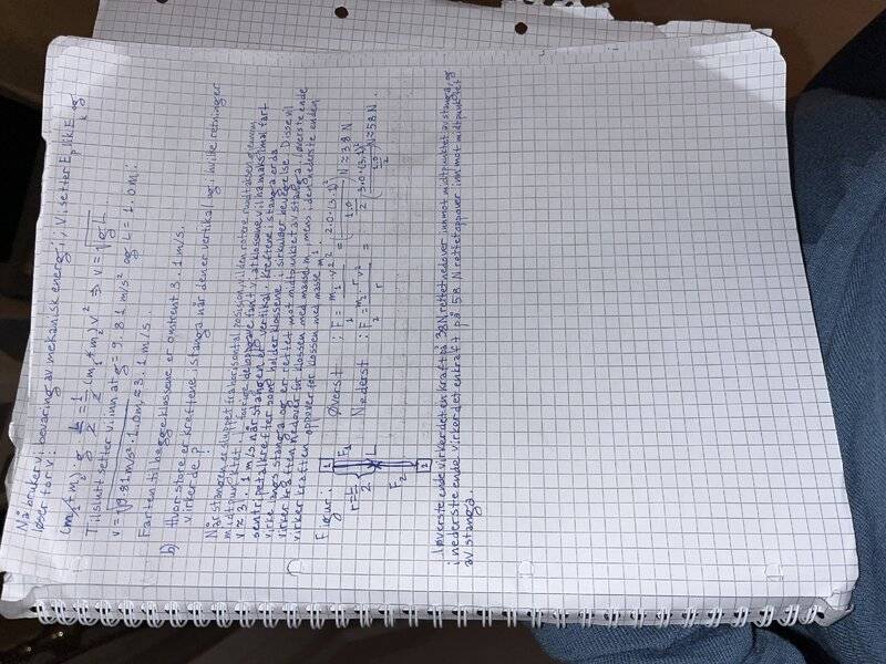

Ok, so my notes are in Norwegian, but you’ll probably get the essence of it based on the equations. For the first question I basically just used conservation of mechanical energy and solved for the speed v. The second question, I used the speed from the first question and found the centripetal force on each end of the rod. Finally for the last question I just find that the only forces acting are the gravitational forces of the two blocks, but this feels kind of wrong(?) Please tell me what you think? How would you solve this kind of problem?
Sorry, your notes are illegible, not to mention sideways. Also, "getting the essence" is not good enough because the Devil is in the details. Your strategy sounds fine for the first two parts but what about its implementation? I can't tell unless I can read your work . . . in English.

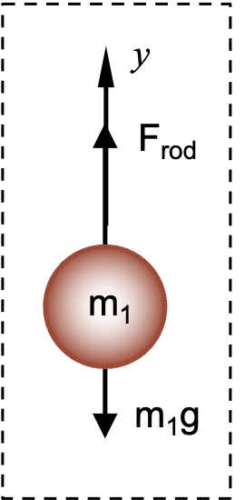

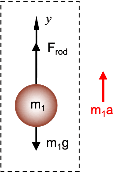

Being terrible at FBDs does not mean that you cannot do something to stop from "being terrible". Here is a tep-by-step recipe that I have used in my classes. It will see you through as long as you perform each step in order without omitting any step or doing things in your head. I have attached figures next to each step t show how the FBD develops. The method works best if you use symbols instead of numbers.
1. Identify the system and draw it.
The system is the mass ##m_1=3~## kg at the bottom of the trajectory.
2. Identify all the pieces of the Universe that interact with the system and count them.
The pieces that interact with ##m_1## are the Earth that attracts it and the rod that is attached to it. This makes a total of two pieces.
3. Draw one and only one arrow representing the force exerted by each of the items in (2). Label each arrow unambiguously.
See figure on right. The Earth exerts force ##m_1g## that is always down. The force exerted from the rod must be in a direction along the rod, i.e. vertical. It cannot be up because if it were, the mass will accelerate vertically down and not go around in a circle.
4. Choose a convenient coordinate system and draw it. Enclose your system, axes and forces in a
box with dotted lines.
Positive direction is up as indicated by the arrow labeled ##y##.
5. Declare the acceleration. Draw an arrow outside the box indicating the direction of the acceleration. If you have chosen the coordinate axes wisely, the acceleration will be along one of the principal axes (x or y). Label the arrow "m"a, where "m" is the symbol you used for the mass in (1).
Mass ##m_1## is going around in a circle. Since all the force vectors in the diagram are along the vertical, the acceleration can only be along the vertical, up or down. Now the mass is going around in a circle centered directly above ##m_1##. The acceleration is centripetal (towards the center), hence its direction is up.
6. Add all the forces vectorially to obtain the net force, the left side in Newton's second law. Check that the vector sum of the arrows inside the dotted line gives a resultant vector in the direction of the "mass times acceleration" vector that you drew outside the dotted line in (5).
Anything up is positive and anything down is negative, so $$F_{\text{net}}=F_{\text{rod}}-m_1g.$$7. Set the net force vector equal to the mass times acceleration vector outside the FBD. Solve for what you are asked to find.
$$F_{\text{net}}=F_{\text{rod}}-m_1g=m_1a$$ Since the acceleration is centripetal, $$F_{\text{rod}}-m_1g=m_1v^2/(L/2).$$ You have the speed ##v## from a previous part, you need to solve the force exerted by the rod on the mass. The force exerted by the mass on the rod has the same magnitude and opposite direction to that.
If you are serious about improving your free body diagram skills, apply this step-by-step method to find the force exerted by the other mass on the rod and consider using it in the future.
ymnoklan said:
Thank you so incredibly much for all of your help! I truly appreciate it. Using your hints I get that:
sigma_F_1 = T - G = m_1*v^2/r => T_1 ≈ 27.5 N down, G_1 ≈ 29.4 N down
sigma_F_2 = T + G = m_2*v^2/r => T_2 ≈ 41.2 N up, G_2 ≈ 29.4 down,
where T is the force(s) from the rod to the mass(es) and G is the gravitational force(s) from the mass(es).
##G_1## and ##G_2## are different. Maybe that was just a typo.
As @Steve4Physics mentioned, it is much better to work algebraically. Don't plug in numbers until you have to. So far you have ##v^2=\frac{(m_2-m_1)gL}{(m_2+m_1)}##.
You need to define which way is positive for your forces. It doesn’t matter what you choose as long as, for each one, you are consistent.
Say we take towards the axis as positive always. Then we have ##T_1+G_1=m_1\frac{v^2}{L/2}##, ##T_2-G_2=m_2\frac{v^2}{L/2}##.
What does that give you for the tensions?
