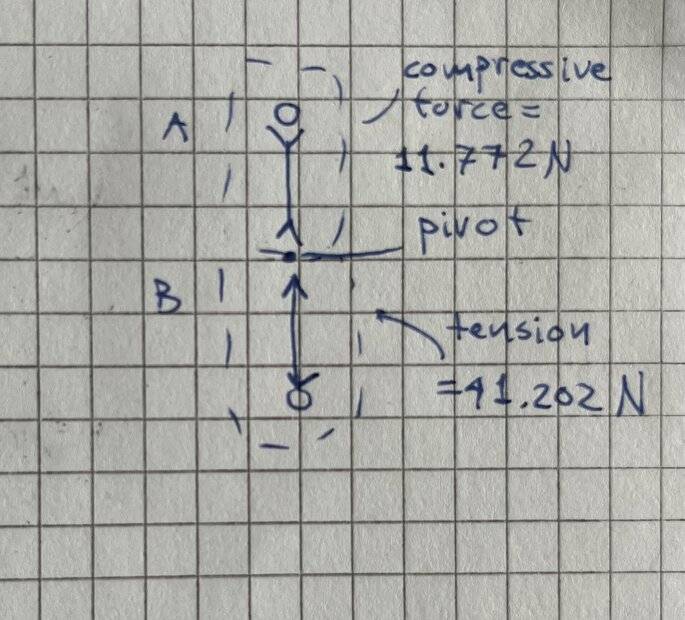

Answer these questions please.
From earlier posts we know the that:
- the upper half of the rod (A) is being compressed (compressive force = 11.772N);
- the lower half of the rod (B) is being stretched (tension =41.202N).
Q1 What is the size and direction of the force that A exerts on the pivot (if you are unsure, make sure you understand Post #59).
Q2 What is the size and direction of the force that B exerts on the pivot (if you are unsure, make sure you understand Post #59).
Q3. What is the total force on the pivot?

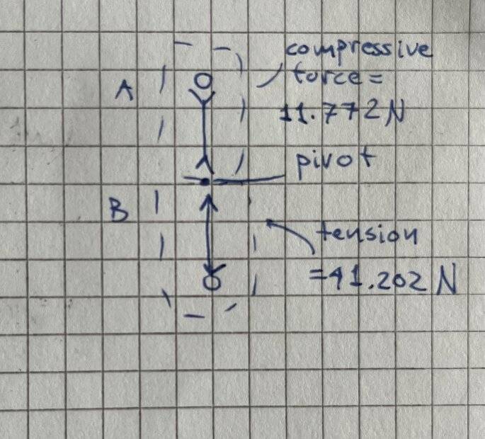

Q1: 11.772 N up, Q2: 41.202 N up, Q3: 11.772 N up + 41.202 N up = 85.974 N up
Is this correct?
(I added a sketch of my understanding of the situation).
  • #63
Is this correct?
No. But the sketch was a good idea.
A is in a compressed state. That means it is pushing whatever is attached to its ends outwards. Like a compressed spring pushes whatever is attached to its ends outwards.
B is in tension. That means it is pulling whatever is attached to its ends inwards. Like a stretched spring pulls whatever is attached to its ends inwards.
I think you are confusing the forces which are applied to the rod with the forces applied by the rod.
Suppose objects X and Y are attached to a horizontal spring:
X\ \ \ \ \ \ \ \ \Y
If X and Y are pushed inwards, the spring is compressed:
##\rightarrow##\\\\\\\\\##\leftarrow## where the arrows show the forces of X and Y on the spring.
Then the force on X is outwards, to the left:
X##\leftarrow## where the arrow shows the force exerted by the spring on X.
And the force on Y is outwards, to the right:
##\rightarrow##Y where the arrow shows the force exerted by the spring on Y.
I used Newton's 3rd law.
A similar argument can be used if the spring is stretched.
Does that change your answers to the Post #61 questions?

That makes sense. Is this correct then?:
A is exerting a force outwards (down), B is exerting a force inwards (up) =>
ΣF = 41.202 N (by B) - 11.772 N (by A) = 29.43 N up
  • #65
A exerts two forces: a force on the pivot and a force on ##m_1##. You need to be clear which force is down. But I assume you mean the force on the pivot, so you are correct.
B is exerting inwards forces on the objects attached to its ends. But the pivot is at the top of B, so what is the direction of the force of B on the pivot?
  • #66
Of course. Is the pivot subjected to two downward forces then?
ΣF = 41.202 N (down by B) + 11.772 N (down by A) = 52.974 N down

  • #67
Just in case there is any confusion...
We have objects X and Y attached to the ends of a rod.
When we say 'inwards' forces act on X and Y, we mean the forces on X and Y are directed towards the centre of the rod.
When we say 'outwards' force act on X and Y, we mean the forces on X and Y are directed away from the centre of the rod.
'Inwards' and 'outwards' in this context do not refer to towards and away from the centre of the circle.
  • #68
Yes. You got it!
Edit: But don't forget to round the final answer to a suitable number of significant figures.
