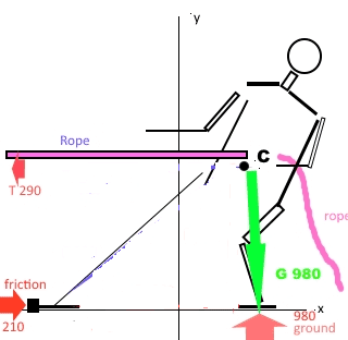

Perhaps a diagram..

Lets assume the man isn't falling over. eg he is not rotating about his feet. (Technically I should say that he's not subject to rotational acceleration). To meet that condition the sum of the torques about his feet must also add to zero. So the anticlockwise torque due to his weight must equal the clockwise torque due to the tension in the rope.
I also have to make some assumptions about how high up the man the rope is attached and where his centre of mass is. Let's say that the rope is attached to the man at height hr when he is stood up. So it's at hr*sin(theta) above his feet when he leans at theta. Likewise his centre of mass is at hm when he is stood up straight and hm*sin(theta) when he is leaning.
Note that _if_ m,g,hr and hm are constants then in order to apply 300N he must lean at the correct angle which might not be 45 degrees. I'll let you substitute values and solve for theta.
If you insist the man must lean at 45 degrees then he would have to change hr to make the torques sum to zero. Otherwise he will either fall or be pulled upright. (edit: or he cannot apply 300N to the rope, something must change to ensure the torques sum to zero).
In short if he's not accelerating (be it linear or rotational acceleration) then
The vertical forces must sum to zero
The horizontal forces must sum to zero
The torques must sum to zero.

There are three forces acting on the man. Gravity is exerting a force of mg vertically downwards. The tension is exerting a force T horizontally. The ground is exerting a force R at an angle of θ from the ground.
Assuming that the man is not accelerating then by Newton's 2nd law we can write algebraic expressions relating the vertical and horizontal components of R to T and mg. Using those two equations you can solve for θ and R in terms of T and mg.
Why don't you try that?

Sorry for delay in replying. I'm in the UK.
bobie said:
The diagram is great but vanishes when I quote. Can you place one somewhere on the web so that I can pick it up?
http://i586.photobucket.com/albums/ss303/CWattersUK/TruckpullTorque.png
There is something I still do not understand:
there is no horizontal force on the ground in this sketch
I summed the torques about the mans feet. Torque = force * distance but the force you refer to is at the feet so the distance is zero. Likewise there is no vertical force shown at the mans feet.
if the man's weight is 100 kg , then the force of g is 1000N right? so the force of 300N is unrealistic? any ideas what pulling force a strong man of 100Kg can exert?
Consider what happens if the rope is attached to the man's centre of mass so that hr = hm= h and then he leans at 45 degrees.
Let the Tension in rope be T.
The man isn't accelerating/rotating so the torques sum to zero..
mg*h*cos(45) + T*sin(45) = 0
Solve for T
T = -mg*h*cos(45)/sin(45)
cos(45) = sin(45) so that cancels
T = -mgh which could easily be 1000n if the man weighs 100kg
Note: This explains why it's best for the man to hold the rope low down close to the ground. Perhaps even below his centre of mass. You get the leverage effect of hm/hr if they are different.
why can't he stand at 45° as long as the truck doesn't move??
He can but the tension in the rope might not be 300N.

Consider this statement..
If a "ideal man" stands perfectly upright then it's not possible for him to exert any force on the rope.
By ideal man I mean one with feet of zero length so that his centre of mass is directly above his point of contact with the ground.
In this situation there is nothing to balance the torque produced by the rope. He mustlean back, or do something similar such as putting one foot behind the other which amounts to the same thing. Otherwise even the slightest tension in the rope would pull him over.
In short, even if there is sufficient friction with the ground, the limit to how much force he can apply on the rope is controlled by his mass and the geometry.
Aside: Find a strong man and have him stand with his heels and back to a wall. Tell him he can't move his feet. A skinny kid could pull him over easily as the man cannot get his centre of mass more than about a foot behind his point of contact with the ground.
  • #59
CWatters said:
, or do something similar such as putting one foot behind the other which amounts to the same thing. Otherwise even the slightest tension in the rope would pull him over..
Sure, but when CoM is beween the feet gravity exerts no torque and all its force is applied to the ground and is to no avail, like in the picture I posted, there the rope is about the height of center of mass (sternum) which is inside the base of the feet. he cannot exploit gravity.
  • #60
That's not correct. He can "exploit gravity" right up to the point where all his weight is on his front foot.
Consider what happens if something pulls on the rope with increasing force. At some point the man starts to rotate about the front foot and his rear foot just lifts off the ground. That sets a limit on how much force he/it can apply. eg how much he can exploit gravity. All the while his centre of mass is between his feet.
