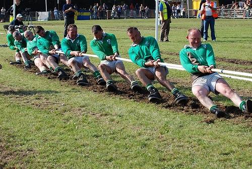

Can someone give a detailed phusical description description of the forces involved in this game?
Let consider only the first player on the right:
Photo of a tug of war: a row of men in matching green shirts and grey shorts lean back and pull a white rope, heels digging into muddy ground, with spectators and marshals behind.
0) does it make any difference if he is pulling aagainst an opposing varying force or he is pulling a truck?
1) does friction play any role here? if his heels are dug in a hole or lean on a reversed starting block, does it make any difference?
2) his legs are fully stretched. Can he exert a force directly on the ground?
3) can he exert a greater force either on the rope or on the ground
4) if yes, how
5) if no, is it due to Newton third law? suppose his legs are stretched and the ground is just a point of support: when he pulls the rope is half force discharged on the ground?
6) if he wants the rope to accelerate in his direction is it necessary that the two forces be unequa? Is it true that if they are equal the total force on the player will vanish?
6) in conclusion, after all your evaluations which force is more important for victory, the one on the rope or the one ond the ground
Thanks in advance, it would be great to have a sketch of the forces in play showing how forces are discharged to the ground.

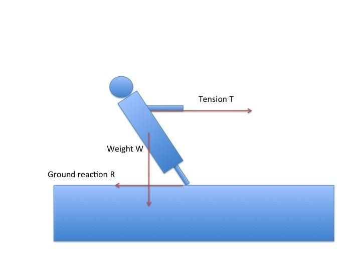

Assuming no hand slippage, the tension in the rope is the same pulling on each team. Although there are complexities involved, friction/traction of feet on ground is key. If one team is on ice and the other on soil, I bet you know who wins.
The diagram I had in mind is below (jeez, I'm good to you, aren't I?)This is the essence of the one man pulling a rope attached to 'something' and I am assuming that things are in equilibrium, for a start. It assumes the man is strong enough to provide the tension and the leg thrust and that the friction with the ground is enough to hold him. To work out the tension, you need to consider the Moments about a point (choose his contact point with the ground). The moment of the tension will be equal and opposite to the moment of his weight. He will need to be at the correct angle to the ground for this. The calculation involves some Trig - but I have left it out, initially.
There are just two horizontal forces here, so T will equal R.
If he is 'winning' then T will be enough to drag the truck and he will need to be walking backwards, so he does T times x work, where x is the distance moved. I assume the truck is moving very slowly and not accelerating appreciably. All the work done is against friction. If he is actually managing to produce significant acceleration then you would need to include the kinetic energy situation too.
If T increases then he needs to lean back more and the friction needs to be high enough or he will fall on his backside or start 'surfing' through the mud (if he can control it).
PS Powerpoint is easy to use to produce this simple diagram -once you get used to it.
  • Free-body diagram of a stick figure leaning back at an angle on a horizontal surface, with a rope pulling right labelled Tension T, a vertical arrow labelled Weight W, and a horizontal arrow labelled Ground reaction R pointing left at the foot.
Free-body diagram of a stick figure leaning back on the ground, with horizontal arrow labelled Tension T pointing right, downward arrow labelled Weight W, and horizontal arrow labelled Ground reaction R pointing left.
How can those forces be in equilibrium, if the ground reaction acts only horizontally?

Forces do not work this way. You are thinking of something which is conserved and so you can say that 50% goes here and 50% goes there. Forces are not conserved. For example, on a simple lever you may exert a force of 10 N and get out a force of 100 N. Talking about "lost" or "percentage" of force just doesn't have any physical meaning. That is probably why you are not getting good answers to that part of your question.
The reaction R against the Tension is horizontal. Of course there is another vertical force to balance weight etc.
I could put more arrows in - plus angles and distances etc. But this is a very stock 'Forces' situation. Other well known ones are ladders leaning against walls and men pushing wheelbarrows. Once you've seen and done one, you've seen 'em all.
R is not the reaction to tension. R is the reaction to the force that the foot applies to the ground.
If you put the weight into the diagram, then you should also put in the vertical ground reaction force. Otherwise there can be no balance.

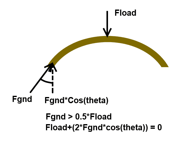

No, I was not thinking that. I have little experience but I was thinking of an arc, a vault. When you exert a vertical force on a bridge, an arc most of it is discharged horizontally, that is why a fortress has flying buttresses. Now, when you pull on the rope and on the truck you have to prop up to the ground, and , I thought, you must discharge some force on the ground.
Is that a wrong deduction?
Forces are "exerted" or "applied" not "discharged". When a book rests on the table, it can exert a force on the table indefinitely, without the need to ever "recharge", so it is misleading to talk about "discharging" forces.
If you are in balance (not accelerating) then all the forces you exert must sum to zero. So if you pull the rope with some horizontal force, you must exert an equal but opposite horizontal force on something else, like the ground.

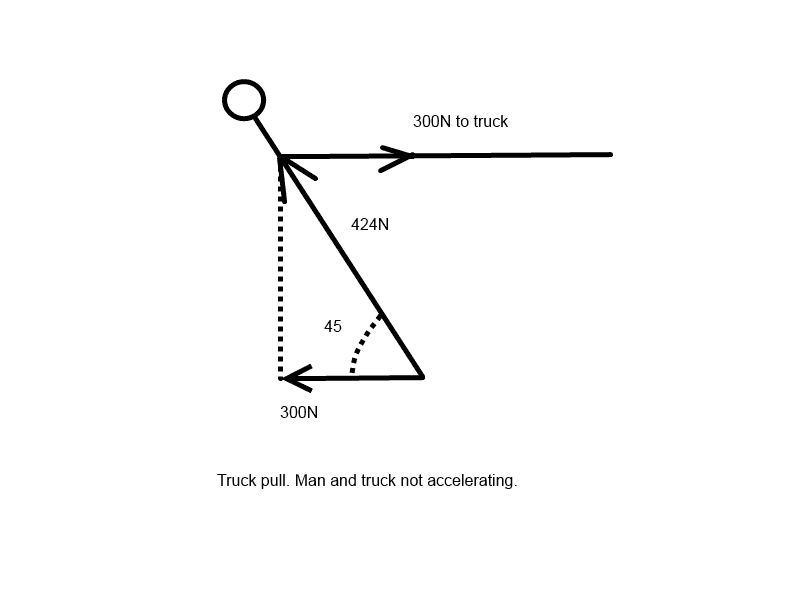

2) if you pull the rope with some horizontal force, you must exert an equal but opposite horizontal force on something else, like the ground.
1) not discharged, what then, deviated? how do you account for the force pushing a wall laterally when a force is applied vertically to arc? where does it come from?
2) if you apply a force of 300N to the rope/train how can you apply an equal extra 300N force on the ground? wouldn't that add up to 600N?
That is exactly what I said and was rejected:
wherevere you exert a force, as you must prop up on the opposite side, you discharge half of the force on the other side
That is what I meant : 150 + 150 N, now you say 300+300N, but the principle is the same, maybe it is not due to 3rd law, but the concept is evident, undeniable anyway.
Read again. it says "equal but opposite", not "equal". Two equal but opposite forces add up to zero.
A.T. said:
Read again. I told you two common terms.

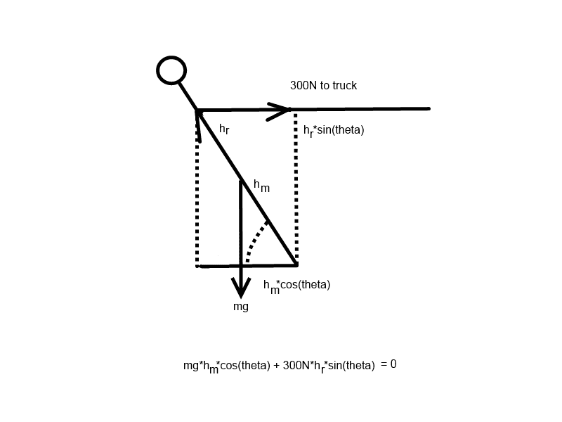

You said 'exerted' 'applied', but on an arc the applied/exerted force is vertical, how much of it goes horizontal ? and are you saying this is the applied force? that you applied force laterally?
2) the point is that here the sum is not 0: you have a net force of 300 N applied to the truck whose reaction is -300N, then it the truck does not budge you have the equilibrium.
But you said literally
"So if you pull the rope with some horizontal force, you must exert an equal but opposite horizontal force on something else, like the ground."
if those forces add up to zero you are not exerting any force on the truck.

No, I was not thinking that. I have little experience but I was thinking of an arc, a vault. When you exert a vertical force on a bridge, an arc most of it is discharged horizontally, that is why a fortress has flying buttresses...
The arc or buttress changes the angle the force makes with the ground BUT it also increases the total forces on the ground.
The vertical component of the force on the ground ends up unchanged. It has to be because if the bridge isn't [STRIKE]moving [/STRIKE] accelerating vertically the vertical forces on it must still sum to zero.
  • Free-body diagram of a curved brown arch with a downward load Fload at its top and a reaction force Fgnd at its left foot, angled at theta from vertical, with the vertical component Fgnd*Cos(theta) shown; text reads Fgnd > 0.5*Fload and Fload+(2*Fgnd*cos(theta)) = 0.

Moreover if you are standing at 45% you are not exerting the force horizontally on the ground but at 45° and the horizontal component is 300* cos λ =210 N, right?
I think you have that the wrong way around.
If you aren't [STRIKE]moving[/STRIKE] accelerating the horizontal component of the force you exert on the ground must be equal to the tension in the rope eg 300N. So the total force your legs must exert at 45 degrees must be higher..
Compression Force in legs * cos(45) = 300
Compression Force in legs = 300/cos(45) = 424N
If you don't apply 424N at 45 degrees the horizontal component can't be 300N and you will be [STRIKE]moving [/STRIKE]accelerating one way or the other.
