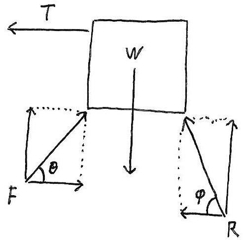

  • #103
bobie said:
Why should the forces on the forefoot add up to 980N..
I didn't say that the forces on the forefoot must add up to 980N.
  • #104
Do you think the diagram is now OK? Are there any more problems?
  • #105
Personally I wish you hadn't complicated the situation by separating front and rear feet!
I don't believe you can calculate the total force on the front foot unless you calculate how the 300N friction force is shared between each foot. So I attempt that...
We have established that if the man was to lift his rear foot off the ground it appears he would apply 980N of force to the rope. If he only wants to pull with a force of 300N then some of the excess torque generated by his mass must be supported by his rear foot (which is under his COM)
If I make reasonable assumptions about the geometry of the drawing then the vertical component of the force on the rear foot must be 980-300=680N.
Then if the vertical components must add to 980N the vertical component of the force on the front foot must be 980-680=300N
Now look at the horizontal components...
The horizontal forces due to friction must sum to 300N but how much is carried by each foot? If we assume that the friction force is shared in proportion to the load on each foot then the friction force on each foot is
Front..
300* 300/980 = 92N
Rear..
300* 680/980 = 208N
So now we have horizontal and vertical components for the force on each foot...
Front...
Vertical = 300N
Horizontal = 92N
Rear..
Vertical = 680N
Horizontal = 208N
You can apply Pythagoras to work out the total force on each foot and some trig to work out the angle.
I'll just do the front foot...
Total^2 = 300^2 + 92^2
Total = 313N
Your diagram appears to show 424N but you don't explain how you get that figure.
  • #106
I agree. I suggested a simplified scenario several pages ago. I think it is better to start simple and add complications later.
  • #107
Ok this is my final word on this problem. Got to fix a leaking WC! I have produced the following diagrams.
1) The first shows some assumptions about the geometry such as him leaning at 45 degrees and his COM being over his rear foot etc. I also assume he is not accelerating (vertically, horizontally or in rotation).
2) The second shows the how the torques must sum to zero. The distances from the pivot are all the same due to the geometry. Let's call that distance h (see assumptions drawing). If we take anti clockwise as +ve then..
-980*h + 300*h + 680*h = 0 √
3) The third diagram shows the consequences for the vertical components. Let's take vertical as positive then
-980 + 300 + 680 = 0 √
4) The fourth diagram shows the horizontal components. I have made the reasonable assumption that the 300N friction force is shared in proportion to the vertical load on each foot. That calculation is done on the diagram. Let's assume right is positive then..
92 + 208 + (-300) = 0 √
5) The final diagram combines the horizontal and vertical components at each foot to give the total force at each foot (using Pythagoras and basic trig.). Note that the total force acting on each foot acts at about 73 degrees to the horizontal. There is no reason why this should be 45 degrees.
That's all folks.

  • #108
PS: Some may question my assumption about the way the friction force is shared between the two feet but I think it's perfectly reasonable for a flat uniform smooth floor like a Gym. You also have to remember that in this problem the man is NOT trying to pull as hard as he can (980N at 45 degrees). He is only applying 300N. Most of his weight is carried by his rear foot.
  • #109
I like that assumption also, I think I would have made the same one. It is interesting that one consequence of that assumption is that the forces from the ground are parallel to each other.
The other assumption I might consider would be that the forces are whatever is required to minimize the torque about the hips. But that seems excessively complicated.

I figured an angle of 10°-15° for LF, but I am not sure when 148 is right. What we know for sure is that the R-leg angle must be 45°, at least as a starting point, else we would be introducing too many variables.
If G on LF 856N, the left foot will gain the necessary 124 N missing to reach the balance (-88-212) the horizontal F-x which is necessary to compensate the torque fom the rope +300N.
If you agree on this A diagram, I'll show you the next step, when there is tension on the rope.
If you had enough, I thank you for your invaluable help that has guided me in this tangled issue.

bobie said:
your basic assumption is that g is transmitted entirely on the back foot.
Not what he said. Read again.
bobie said:
This situation is unrealistic
Place the feet differently, assume higher tension, and you get a different distribution.
bobie said:
As you can see there is Fx from gravity on LF
You are confusing friction with gravity.
bobie said:
any civil engineer will confirm that a weight on sloping supports generates a horizontal force
There is no slope here.
  • #112
bobie, this is incredibly frustrating. You are completely ignoring large portions of what we actually do say and completely inventing things that none of us ever said and pretending that is what we said. Please read what we write and don't invent what you want to hear but actually learn what was said. If you have questions about what we say then ask, but don't put words in our mouths.
bobie said:
You may be right, but your basic assumption that LF is bang under the COM and consequently g is transmitted entirely on the back foot.
No, he never said that. g acts at the center of gravity and is not transmitted at all. Furthermore, the normal force on the rear leg is only 680 N, so even if you want to refer to the ground reaction as a "transmitted" g force it is not entirely on the back foot.
bobie said:
I have followed DaleSpam advice and started from the simplest position: no rope.
The scenario that I suggested as being the simplest was to have only one leg. It is not a tug of war without a rope, but you certainly could have a one-legged tug of war.
bobie said:
DaleSpam disagrees but any civil engineer will confirm that a weight on sloping supports (and the legs are sloping here) generates a horizontal normal push/ force)[/I].
This is not true, and it is also not what I said. Your putting words in my mouth is really starting to irritate me.
Ask any civil engineer you like to draw a free-body diagram for a tug of war man on flat ground. I guarantee that not one of them will break g into vertical and horizontal components. At the ground there may or may not be a horizontal component of the reaction force, depending on the assumptions they make, but I guarantee that none of them will put a horizontal component of gravity.
  • #113
I am awfully sorry if I irritated you, but I was not referring to Tug-of-war.
I am saying that just standing on ice or on a waxed floor and with your legs astride at an angle of less than 45/35°, you will see that there is a horizontal pull on your foot.
In picture A only gravity is acting on the man, and friction from the ground and the block offers a reaction to that, and that +F on rear foot compensate the -F suggested by CWatters.
I realize the discussion has been lengthy so I thank you all again
  • #114
No, there isn't. What there is is a bending moment about each of your hip joints.
If you are on a frictionless floor then by definition there is no horizontal force at the ground, and there is never any horizontal component of gravity. Because there is no horizontal force at the ground, there must be an outward bending moment about each hip, which you compensate for by using your hip adductor muscles.
The hip adductor muscles are the same muscles that you would use to oppose a genuine horizontal pull at the floor. So perceptually it feels very similar, but there is in fact no horizontal pull and the bending moment you are opposing with those muscles is generated by a purely vertical force.
Again, ask any engineer you like to draw a free body diagram of a man on flat ice with legs astride and I guarantee that they will not break gravity into horizontal components.

DaleSpam said:
No, there isn't. What there is is a net torque about each of your hip joints.
Pardon my ignorance, DaleSpam, but a torque on hip does not mean that your foot is pushed outward? if so, I poorly expressed my self, else I'll learn something completely new.
Is this what you meant 1 foot?
http://s47.photobucket.com/user/lisa0rg/media/Man2F_zps48a11680.jpg.html?filters[user]=141333040&filters[recent]=1&sort=1&o=0
What is the force of gravity acting on the two legs? (and on the block)?
  • #116
The torque at your hip is your muscles pulling your legs toward one another. Because of this torque, your legs are supporting an inward-and-down sheer stress in addition to an outward-and-down compression stress. If you standing in an equilibrium on frictionless ice there can be no net inward or outward force on either foot. The combination of the sheer force and the compression force must be purely vertical.
Your feet are not pushed outward by the ice. They are pushed upward. As Dale has pointed out, this feels the same as if they are being pushed outward because both forces cause torques in the same direction.
Gravity acts on the body. A force from the body (at the hips) acts on the legs. A force from the legs (at the ankles) acts on the feet. A force from the feet (at their bottom) acts on the block.
The force of gravity does not act on the block, except, of course, to the extent that the block has mass.
  • #117
jbriggs444 said:
1) Your feet are not pushed outward by the ice. They are pushed upward.
2)
1) I could not understand as that is absolutely new to me. When I was on a waxed floor once, I thought my feet were pulle apart.
Besides , even now, when I climb theseon one of these to change a bulb, if I forget to properly spread the sides,as soon as I mount they are immediately pushed apart.
I hope you confirm that it happens to you, too. And that is why this tool has rubber shoes.
Now if this is true, can you explain to me what is the difference between a ladder and a leg? Why doesn't a leg behave like a ladder?
2)Are you referring to the image? G does not push on the block when exerting the torque on the body? what is the value of G-torque (red on the circle)?
  • #118
This situation is unrealistic...
I totally agree but then I'm not trying to make the problem realistic. I'm trying to show you how to go about solving this type of problem.
  • #119
That's silly. Your foot is pushed out because the angle of your leg decreases while staying the same length and being attached to you. As DaleSpam said, all related to your COG and vertical gravity vector from there. You should be able to tell the difference between that and pulling on your foot. :smile:
  • #120
The legs are rotated apart because the vertical forces on your feet create a troque around the hip. There are no horizontal forces pulling the feet apart.
No, the body pushes on the bloc.
