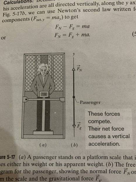

A passenger of mass ##m=72.2 kg## stands on a scale in an elevator cab. We are concerned with the scale reading when the cab is stationary and when it’s moving. ie ##F_N=m(g+a)##.
When the cab is stationary or moving up with constant velocity what is its scale reading. ie ##F_N=708 N##. This is the weight of the passenger.
What does the scale read if the cab accelerates with ##3.20 m/s2## upwards and downwards. ie ##F_N=939## and ##477 N##.
For an upward acceleration the scale reading is greater than the passengers weight.
” That reading is a measurement of an apparent weight because it’s made in non inertial frame”.
I don’t understand this line.
During the upward acceleration what is the magnitude ##F_{net}## of the net force on the passenger and what is the magnitude ##a_{p,cab}## of his acceleration as measured in the frame of cab. Does ##\vec F_{net}=m\vec a_{p,cab}## ?
##\vec F=m\vec a##
I mentioned answers above in the question.
As I understand it, the line that you do not understand is:
This is a question about terminology. Not a question about physics. It is about what is meant by "apparent weight".
The idea is that if you have an object that is held at rest in an inertial frame supported by nothing but a scale, the force that you measure with the scale is the object's true weight. By Newton's second law, the measured support force it will be equal and opposite to the force of gravity on the object, the object's true weight. ##\sum F = \text{(scale reading)} - mg = ma = 0##.
If you are using an non-inertial frame such as the rest frame of an accelerating elevator cab. Then you can still perform the same measurement procedure. You arrange for the object to remain at rest relative to your accelerating elevator cab. It is supported by the scale alone. You look at the scale reading and declare this as the object's weight.
If we look at this same scenario from the point of view of an inertial frame, we see that the "true weight" is not equal to the support force from the scale this time. ##\sum F = \text{(scale reading)} - mg = ma## but ##ma## is non-zero this time.
Still, from the point of view of an observer sitting in the elevator cab and not looking out through a window or acknowledging the flashing floor numbers, the scale reading seems like a perfectly good weight measurement in a higher (or lower) than normal gravitational field. It is an "apparent weight".
I am not a fan of this terminology. But it is just terminology. It does not change the physics.

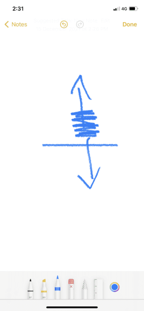

I really thought about it and I don’t understand how an upward acceleration or upward force increases weight of the body?
Suppose there is a traditional weighting scale with springs like this .
I don’t see how an upward acceleration will stretch the spring even more?
An upward acceleration means the vertical force exerted by the scales exceeds mg. Therefore the force the mass exerts on the scales exceeds mg.
The upward force on the scale, which has a mass, is the first thing that happens.
Then, the momentum of the scale increases and upwards acceleration begins.
The inertia of the passenger’s body resists that.
The spring is caught in between the accelerating scale and the body that resists that acceleration.
Please, see:
https://en.m.wikipedia.org/wiki/Newton's_laws_of_motion#Second_law
I don’t want to say thanks because that will end this topic. But Thanks.
So the spring is pulled from both sides. So magical!
In the downward acceleration the spring is compressed from both sides.
