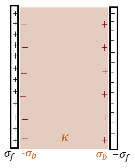

Assume the dielectric fills the space between the parallel conducting plates:
Neglecting edge effects, the force on the left sheet is due just to the electric field produced by the free charge ##-\sigma_f## on the right sheet. The bound charges ##\sigma_b## and ##-\sigma_b## produce no net force on the left sheet. The magnitude of the field produced by the free charge of the right sheet is ##\large \frac{\sigma_f}{2\varepsilon_0}##. Thus, the force on the left sheet is $$F = Q \left(\frac{\sigma_f}{2 \varepsilon_0} \right)= \frac{Q^2}{2 \varepsilon_0 A}. $$ Here, ##A## is the area of a sheet and ##Q## is the free charge stored on a sheet. ##Q## is related to the potential difference between the plates as ##Q = CV = \large \frac{\varepsilon_0 \kappa A}{d} V## where ##d## is the distance between the plates and ##\kappa## is the dielectric constant. So, the force on the left plate is $$F = \frac{\varepsilon_0 A}{2}\left(\frac{\kappa V}{d}\right)^2$$ This agrees with @Dilwyn Jones's equation for the case where the dielectric fills the space between the plates.
The weight of a plate is ##\rho A t g## where ##\rho## is the mass density of the material of the plate, ##t## is the thickness of the plate, and ##g## is the acceleration due to gravity. So, the ratio ##R## of the electric force on a plate to its weight is $$R = \frac{\varepsilon_0}{2 \rho g t} \left(\frac{\kappa V}{d}\right)^2.$$ Thus, the voltage required to make the electric force match the weight of a plate is $$V = \sqrt{\frac{2\rho g t}{\varepsilon_0}}\frac{d}{\kappa}.$$
As an example, let the plates be thin sheets of aluminum foil of thickness ##t = 0.1## mm and mass density ##\rho = 2.7## g/cm3. Let the dielectric be polystyrene (##\kappa = 2.6##) and the distance between the plates be ##d = 2 ##mm. The voltage required to make the electric force equal the weight of a foil sheet is then about 600 V. This makes the electric field inside the polystyrene equal to about ##3 \times 10^5## V/m which is well below the dielectric strength of polystyrene (approx. ##2 \times 10^7## V/m).
