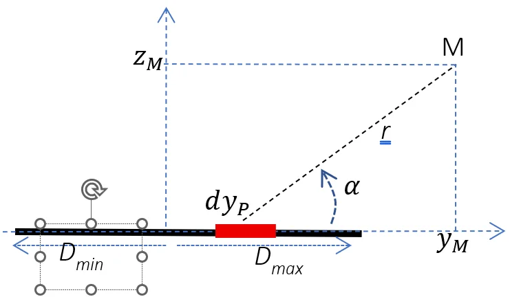

Hello,
I would like to discuss a mathematical point concerning the electric field of an infinite uniformly charged plane.
This question arose while I was discussing an electrostatics exercise with a student. I wrote an article about this (in 2023) in a French journal for french physics professors. I made it available online as a postprint at this link: https://zenodo.org/records/18431824
(But I continued to teach the usual result since it was in the official curriculum for my students !)
The usual result is that the field is strictly perpendicular to the plane and has magnitude ##E = \frac{\sigma}{2\varepsilon_0}##
Below, I reproduce what is a classic electrostatics exercise, which presents the problem quite clearly.
I compute the electric field of an infinite uniformly charged plane by decomposing it into infinite parallel wires.
I redrew a figure to make it easier to read :
Each wire, parallel to the x-axis, has linear charge density : ##d\lambda = \sigma \, dy_P## and produces the field :
d\vec{E} =
\frac{d\lambda}{2\pi\varepsilon_0}
\frac{1}{PM}
\, \vec{PM}
where ##r=PM## is the distance from the wire to the observation point ##M##.
Projecting onto the coordinate axes gives : (The notations are on the diagram.)
dE_y =
\frac{\sigma \, dy_P}{2\pi\varepsilon_0}
\frac{1}{PM}
\cos(\alpha)
$$dE_z =\frac{\sigma \, dy_P}{2\pi\varepsilon_0}\frac{1}{PM}\sin(\alpha)$$
From geometry, ##PM^2=r^2 = (y_M - y_P)^2 + z_M^2## and ##(y_M - y_P) dy_P = -r \, dr## so ##

It remains to pass to the limit of the infinite plane. ##
D_{\max} \to \infty,
\quad
D_{\min} \to \infty
For the vertical component, ##
\alpha_{\max} \to \pi,
\quad
\alpha_{\min} \to 0
## gives ##
E_z =
## as expected.
However, for the horizontal component,
\lim_{D_{\max}\to\infty \atop D_{\min}\to\infty}
E_y
- \frac{\sigma}{2\pi\varepsilon_0}
\ln
\left(
\frac{
\sqrt{(D_{\max} - y_M)^2 + z_M^2}
\sqrt{(D_{\min} + y_M)^2 + z_M^2}
\right)
The result appears to depend on how the limit is taken.
If ## D_{\max} = D_{\min} ## then :
\lim_{D\to\infty \atop D_{\max}=D_{\min}=D}
E_y = 0
But if ##D_{\max} = K D_{\min}## (With ##K## a positive constante):
\lim_{D_{\min}\to\infty \atop D_{\max}=KD_{\min}}
E_y =
- \frac{\sigma}{2\pi\varepsilon_0}\ln(K)
This shows that the horizontal component obtained from direct integration depends on the procedure used to take the infinite limit.
My question is the following:
When computing the field of an infinite uniformly charged plane using this decomposition into parallel infinite wires, what is the mathematically rigorous procedure for taking the infinite limit?
In particular, why is it justified to interpret the integral as a principal value, corresponding to a symmetric extension of the plane around the observation point M?

Hello and thank you for your reply!
No, I have nothing against symmetries. But it seems difficult to impose a priori on the concept of an "infinite plane" the requirement of symmetry. For the concept to be useful, it must model a real-world situation: a charged sheet of finite dimensions at a point that is at a very small height compared to the distance to the edges. For example, when I deduce the field of a parallel-plate capacitor from the field of two infinite planes, I don't say that one must be at the center of the parallel-plate capacitor.
When we talk about an "infinite wire," we don't need to add that it is symmetrical. It is sufficient that the ends of the wire are far apart compared to the distance to the wire. And in the case of the wire, we can make the ends tend towards infinity in any way without any problem.
Furthermore, I believe the symmetry argument is problematic here because the solution for the horizontal component is not unique. The image of a uniform horizontal field with respect to a plane of symmetry is another uniform horizontal field. The equation $x^2=1$ is invariant if we change $x$ to $-x$, but we don't conclude that the solution is 0. When we use a symmetry argument, we say "the field must be in this direction," and if we mirror the system, it must be in the opposite direction: therefore, it is zero. This is only true if the solution is unique.
Actually, the infinite-wires decomposition is a way to decompose the plane to calculate the integral over the charged surface. We could avoid using the term "infinite wires": write the double integral, integrate over ##x##, then over ##y##. This is what we always do when calculating a double integral. We could also integrate first over ##y## and then over ##x##, and there we would find 0. What puzzles me is that if an integral of this type converges, then the result shouldn't depend on how it's calculated. The integral shouldn't depend on how we make the edges tend towards infinity.
This is what happens for the integral of the vertical component: its sign is constant, and we get a finite result with a decomposition, so we can be sure that it converges.
Whereas for the horizontal component, we only find 0 if we impose a certain way of making the edges tend towards infinity. And that seems to me to be the sign of an integral that does not converge.

d\vec{E} =
\frac{1}{PM}
\, \vec{PM}
A transcription error? Should be ##d\vec{E} =\frac{d\lambda}{2\pi\varepsilon_0}
\frac{1}{PM^2}\, \vec{PM}##, right?
Yes, it's a transcription error ! thanks.

I think there are two issues here, a purely mathematical one and a practical one.
In the maths, we can model an infinite sheet as the limit of a rectangular sheet as the extents in the four directions (+/-x, +/-y) tend to infinity. But if the result depends on the relative rates of those tendencies then it is invalid. Yes, the infinite sheet is symmetric, but that does not mean a symmetric analysis is to be trusted.
Consider e.g. ##\int_{-\infty}^{+\infty}\frac{x}{1+x^2}dx##. Would we claim, by symmetry, that it equals zero?
The practical issue is that, there being no such thing as an infinite sheet of charge, the purpose of analysing such a case is to obtain a first order approximation that can be applied to a class of real situations.
As it is commonly taught, the criterion is that the perpendicular distance from the reference point to the sheet is small compared with the sheet's width:
https://www.compadre.org/nexusph/course/A_simple_electric_model_A_sheet_of_charge
It might also be mentioned that it should not be close to one edge, but what @Vincf shows is that that constraint may be too vague; that 'edge effects' become significant before one might expect.
