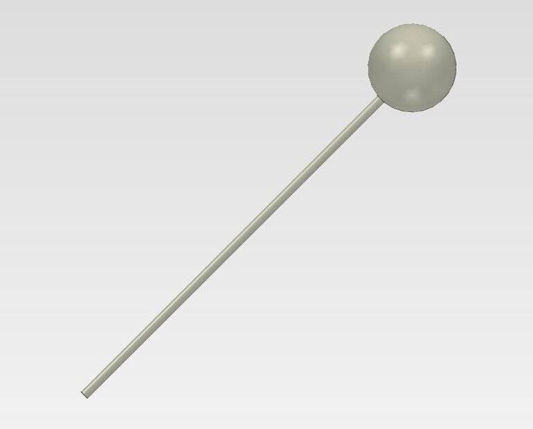

I obtained a very good agreement between FEA and hand calculation for this case. But now I'd like to change the geometry to more pendulum-like:
Side view of a pendulum CAD model: a thin straight rod with a large sphere at its upper end, drawn diagonally against a plain grey background.
The problem is that the aforementioned formula doesn't provide correct results for this case, even though it only needs the pendulum length, not mass as input. I've been looking for some equations for compound physical pendulums since the geometry above likely represents this kind of problem, but I haven't found any formulas equivalent to the one I've been using so far (for the maximum velocity based on angles). In FEA, I can't make the rod massless so I may have to account for the masses of both components even when the rod is very thin.
Do you know where I can find such a formula ? Should I change the assumptions for the analytical calculations ?

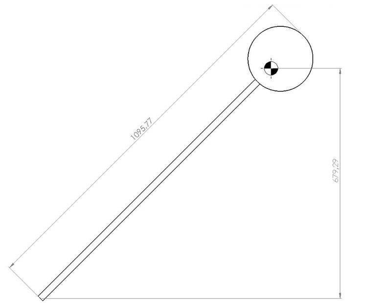

I've tried using this formula in my case and the maximum velocity doesn't agree with the simulation. Here are my inputs:
- total mass ##m=31.1983 \ kg##
- distance from the center of mass to the pivot point in the initial configuration: ##h=0.6792898 \ m##
- moment of inertia about the pivot point: ##I=29.6747 \ kg \cdot m^{2}##
All those values were calculated analytically and confirmed by taking measurements in 3D modeling software so they are correct. The total length of the pendulum is ##1.09577 \ m## and I take it as ##d## since I'm looking for the maximum velocity at the lowest point of the pendulum (bottom of the bob).
Thus, the maximum velocity is: $$v_{max}=d \cdot \sqrt{\frac{2mgh}{I}}=1.09577 \cdot \sqrt{\frac{2 \cdot 31.1983 \cdot 9.81 \cdot 0.6792898}{29.6747}}=4.10175 \ \frac{m}{s}$$
While from the simulation I get ##v_{max} \approx 6.219 \ \frac{m}{s}##
So I wonder if the formula for the maximum velocity is correct.

Yes, here are the dimensions:
Technical drawing of a pendulum: a thin rod hangs from a pivot at the lower left, ending in a large circle at the upper right with a center mark. Dimensions 1095.77 along the rod and 679.29 vertically.
sophiecentaur said:
Tip of disc needs radius added.
Actually, it's still a sphere instead of a disk but I accounted for this in calculations (and they were confirmed by measurements in 3D modeling software so there's no mistake here).
sophiecentaur said:
How far is the disagreement between calculation and sim ?
It's ##4.10175 \ \frac{m}{s}## from the analytical calculations vs ##6.219 \ \frac{m}{s}## from the simulation so really big difference (around ##41 \%##).

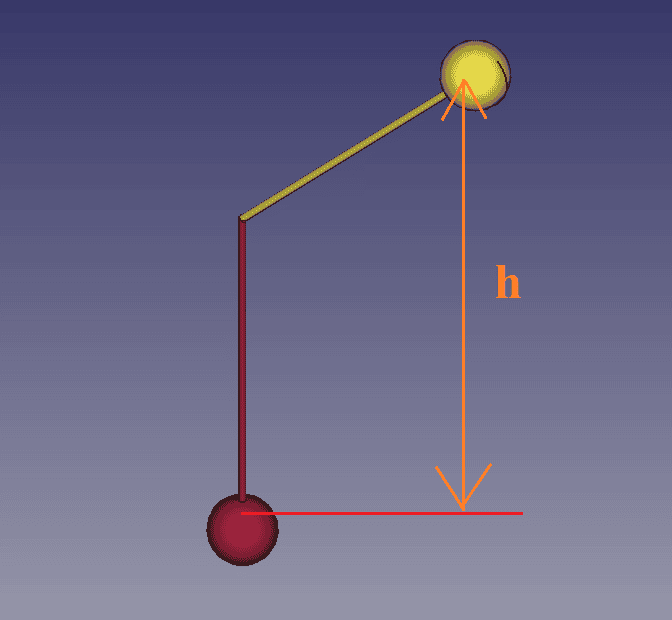

I know what caused this large discrepancy - ##h## was incorrectly defined. It should go from the center of mass in the initial position (at an angle of ##45^{\circ}##) to the center of mass in the lowest (vertical) position:
Diagram of a compound pendulum with a yellow sphere raised at an angle and a red sphere hanging vertically below the pivot, with an orange vertical arrow labelled h marking the drop height between the two centres of mass.
Not just to the pivot point.
Well done. You just made me feel really good then - like the midwife at someone's first baby!!
At one point you expressed doubt about the simulation; well justified. But you need never have doubt about the tried and tested analysis. The faults are always your own and you can correct them.
