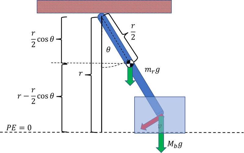

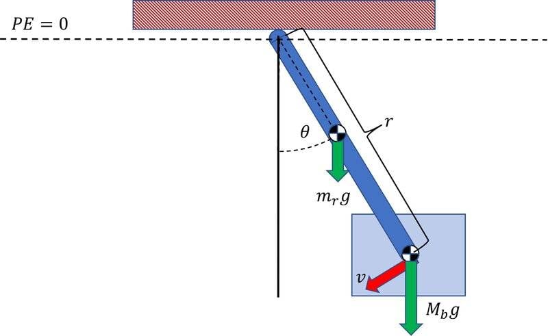

Why is ## \theta_c ## in your expression for ##\omega( \theta )## ? It should be a limit of the integration, not in the integration itself.
An accompanying diagram would be helpful.
Another thing: Is the virtual rod pinned to the bob's CoM, or is it pinned above it?
Also, your potential energy expressions need revised to account for the CoM of the rod
EDIT:
I see. you are using ## \theta_c ## as the variable of integration. I wouldn't do this personally because it is meant to signify a specific angle when the block contacts the ground ( not a range of angles ), but as long as you know what you are doing.
Let's use this and leave everything as variables for the time being so it's easy to check.
$$ PE_o = rg \left[ \left( 1- \cos \theta_o \right) M_b + \left( 1- \frac{1}{2}\cos \theta_o \right) m_r \right] = \kappa $$
$$ PE ( \theta ) = rg \left[ \left( 1- \cos \theta \right) M_b + \left( 1- \frac{1}{2}\cos \theta \right) m_r \right] $$
Thank you for the diagram. I've done my calculations with the virtual rod being pinned to the CoM of the bob and not above it.
The CoM of the rod is included with r = 0.85 so r/2 = 0.425
##1.72*4*9.81*0.425*(1-cos\theta) = 28.68(1-cos\theta)##
I see. you are using θc as the variable of integration. I wouldn't do this personally because it is meant to signify a specific angle when the block contacts the ground ( not a range of angles ), but as long as you know what you are doing.
Any idea on how to signify a range of angles?

Yeah, the starting angle ## \theta_o ## determines ## \omega( \theta ) ##. Say you pick some arbitrary angle ## \theta_a ## to "instantaneously" measure the angular velocity of the bob. If you start the bob at ## \theta_o## very near ## \theta_a ## with no initial angular velocity, when it crosses ## \theta_a ## it will still have very little angular velocity. If you choose ## \theta_o ## further away, it will hve larger angular velocity when it gets to ## \theta_a ##
grvlfun said:
- PE rods = ##1.72*4*9.81*0.425*(1-cos\theta) = 28.68(1-cos\theta) ##
$$ PE_{rod} = m_r r g\left( 1- \frac{1}{2}\cos \theta \right) $$

##PE_{rod} = m_r r g\left( 1- \frac{1}{2}\cos \theta \right)##
Shouldn't it be ## PE_{rod} = m_r r g ( \frac {1} {2} - \frac {1}{2} \cos \theta ) ## ?
## \displaystyle t = \sqrt{ \beta + \varphi} \int_{\theta_o}^{\theta_c} \frac{d \theta}{ \sqrt{ \kappa - rg \left( \left( M_b + m_r \right) - \left( M_b + \frac{1}{2} m_r \right) \cos \theta \right) } } ##
This results in the same equation I had, just written a little different? However, with ## \kappa ## there is still the fact that you provide the starting angle ##\theta_o## and the contact angle ##\theta## ?
No. The CoM of the rod is at ## r - \frac{r}{2} \cos \theta ## ( see diagram )

No. The CoM of the rod is at ## r - \frac{r}{2} \cos \theta ##( see diagram )
That would be the case if the rod is falling to the ground? The CoM of the rod can just 'fall' r/2 and therefore for me it should be ## PE_{rod} = m_rg\frac {r} {2} (1-cos\theta) => m_rgr(\frac {1} {2} - \frac {1} {2} cos\theta)##
And I will try the integration and see what I'm getting as a result, thank you.
No.
## PE = 0 ## is an arbitrary datum that is fixed. We are defining the potential energy of some mass(es) relative to that datum. The ##PE(\theta) ## of either the rod or the bob is defined by where the CoM of the rod or the bob are with respect to our datum for some arbitrary angel ## \theta ##.
Do you agree that the potential energy of the bob vs ## \theta## is given by?
$$ PE_{bob} = M_b g \left( r - r \cos \theta \right) $$
This is with respect to the chosen datum, what do you think is different about defining the potential energy of the rod with respect to our datum?
I'm sorry, but this confuses me.
The change in height is ## \frac {r} {2} - \frac {r} {2} cos\theta = \frac {r} {2} (1 - cos \theta) = r (\frac {1}{2} - \frac {1} {2} cos \theta) ## as I've seen it in different pendulum and physical pendulum problems.
Change in height from ## \theta_o ## to ## \theta ## is ## r (\frac {1}{2} - \frac {1} {2} cos \theta_o) - r (\frac {1}{2} - \frac {1} {2} cos \theta) ##.
r is measured from the fulcrum on, and the distance of the fulcrum axis to the CoM of the rod is r/2. With your equation, when the pendulum is at angle ## \theta = 0 ## the rod would still have a PE of ## m_rgr(1-\frac {1}{2} cos0) = m_rgr(0.5) ##, but at the bottom a pendulum has a PE = 0.
We aren't taking about the changes between initial and final so let's let them alone for now. They might be confusing the issues here.
If you put the PE = 0 at the fulcrum what do you get for the equations?
I'm going to be honest, choosing the PE= 0 at the fulcrum results in an algebraically much cleaner perhaps more understandable picture, with minimal algebraic effort. However, it's none the less equivalent to the result shown above (my bad for not being efficient). Once you re-write the equations w.r.t the fulcrum, either try to prove that identity, or just plug in some values to verify for yourself...I did.
I must say that I completely lost track now with the PE = 0 at the fulcrum.
I just put your integral into wolfram and I'm getting the same values as with ## PE_{rod} = m_rgr(0.5-0.5cos\theta) ## but also there I'm not sure if I did it correctly...
