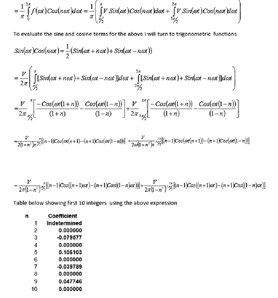

Hi this is my first post please be gentle, I am on a track to answers to this question however my coefficient values seem different to this post and https://www.physicsforums.com/threads/fourier-series-of-a-waveform.766224/page-2#post-5143480.
Am I way off track with my understanding which I have attached for your attention.
Regards

Handwritten-style worked derivation of Fourier coefficients using sine and cosine product identities, followed by a table listing coefficient values for n = 1 to 10, with n = 1 indeterminate.

  • Handwritten-style worked derivation of Fourier coefficients using sine and cosine product identities, followed by a table listing coefficient values for n = 1 to 10, with n = 1 indeterminate.
