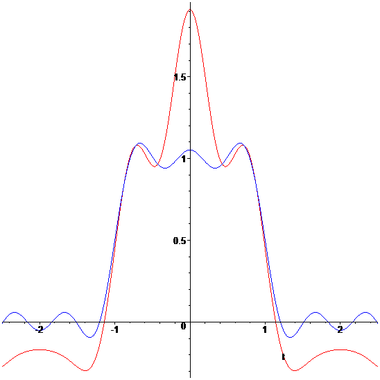

I now take back my statement that you calculated the trigonometric form coefficients correctly; looking at what you did, you made some puzzling blunders. I suggest you start again, carefully. Hint: you should get ##a_0 = 1## (so that the series starts off as ##(1/2)1 + \cdots = 1/2 + \cdots##), ##a_1 = 2/\pi##, ##a_2 = 0##, ##a_3 = -2/(3 \pi)##, etc.
Below, I show a plot of my series (up to n = 6) and of yours (up to n=6); mine is in blue and yours is in red. As you can see, the blue graph looks much closer to the function than does the red graph.

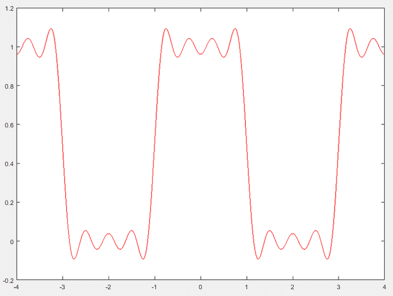

I'm finally making some progress on this:
Trig form:
##x(t)=a_0+\sum ^{\infty} _{n=1}a_ncos(2\pi ftn)+\sum ^{\infty}_{n=1}b_nsin(2\pi ftn)##, where n is the harmonic number.
Where ##a_0=\frac{1}{T}\int ^{\frac{t}{2}}_{\frac{-T}{2}}x(t)dt##. Simplifying, ##a_0=\frac{1}{T}\int ^{\frac{T}{4}}_{\frac{-T}{4}}x(t)dt=\frac{1}{4}[t]^1_{-1}=\frac{1}{4}*2,\ \therefore a_0=\frac{1}{2}##.
Where ##a_n=\frac{2}{T}\int ^{\frac{T}{2}}_{\frac{-T}{2}}cos(\frac{2\pi tn}{T})dt=\frac{2}{T}\int ^{\frac{T}{4}}_{\frac{-T}{4}}cos(\frac{2\pi tn}{T})dt=\frac{2}{T}[\frac{T}{2\pi n}sin(\frac{2\pi tn}{T})]^{\frac{T}{4}}_{\frac{-T}{4}}##
##=\frac{1}{\pi n}[sin(\frac{2\pi n\frac{T}{4}}{T})-sin(\frac{2\pi n\frac{-T}{4}}{T})]=\frac{1}{\pi n}[sin(\frac{\pi n}{2})-sin(\frac{-\pi n}{2})]=\frac{2}{\pi n}sin(\frac{\pi n}{2})##.
Then, ##a_1=\frac{2}{\pi}, a_2=0, a_3=\frac{-2}{3\pi}, a_4=0, a_5=\frac{2}{5\pi}, a_6=0, a_7=\frac{-2}{7\pi}##.
Graph:
Link: http://i.imgur.com/sTPtTlP.png
Exp form:
##x(t)=\sum ^{\infty}_{n=-\infty}c_nexp(j\omega _0tn)##
Where, ##c_0=\frac{1}{T}\int ^{\frac{t}{2}}_{\frac{-T}{2}}x(t)dt=a_0\ \therefore \ c_0=\frac{1}{2}##
##\mathrm{Where,}\ c_n=\frac{1}{T}\int ^{\frac{T}{2}}_{\frac{-T}{2}}x(t)exp(-j\omega _0tn)=\frac{1}{T}\int ^{\frac{T}{4}}_{\frac{-T}{4}}x(t)exp(-j\omega _0tn)=\frac{1}{T}[\frac{-1}{j\omega _0n}exp(-j\omega _0tn)]^{\frac{T}{4}}_{\frac{-T}{4}}=\frac{-1}{j\omega _0nT}[exp(-j\omega _0n\frac{T}{4})-exp(j\omega _0n\frac{T}{4})]=\frac{-1}{j\omega _0nT}(-2cos(\omega _0n\frac{T}{4}))=\frac{2cos(\frac{\pi n}{2})}{j2\pi n}##
Then, ##c_1=0, c_2=\frac{-1}{j2\pi}, c_3=0, c_4=\frac{1}{j4\pi}, c_5=0, c_6=\frac{-1}{j6\pi}, c_7=0##
Am I correct up to this point?
It was nice to check my trig form answer with the MATLAB graph. I believe the graph I have above is part of what he is looking for in part (2). The other part being a plot of the original rectangular pulse function, which is proving a little more difficult to accomplish in matlab. How do I plot the given function?
Next, I don't think I can check the exp form the same way. Part (3) asks for the magnitude spectrum plots up to n=7. I think he wants 3 plots; One for each non-zero ##c_n## coefficient. I poked around MATLAB help and couldn't find a straightforward way to accomplish this. How do I plot the magnitude spectrum plots?
