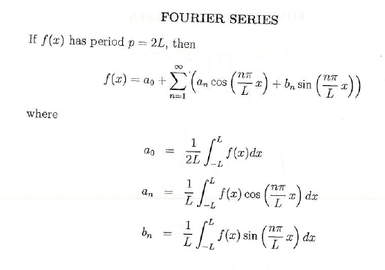

Printed page titled FOURIER SERIES stating that if f(x) has period p = 2L, then f(x) = a0 + sum over n of (an cos(n pi x / L) + bn sin(n pi x / L)), with formulas for a0, an and bn as integrals over -L to L.

also regarding the values for a0, an, and bn (http://i.imgur.com/KIjJQ.png) they are all integrals from -L -> L, but in all the examples I've done or seen (about 3), they've taken the integral from 0 -> L and then multiplied the entire thing by 2.
Now i understand they're halving the region of integration and then doubling the overall answer, but can this always be done when a question asks for a Fourier series of a piecemeal function, whether the fn is even or odd? (with a question of the same style as the one in the OP)
And if so, any reason why my formula sheet gives us a0 etc as integrals from -L to L when we can just make it twice the integral from 0-L?
write out the whole integral, break it into 2 pieces at 0, then use the properties of sin or cos as described last time and it should become obvious. this will only work for odd or even functions
