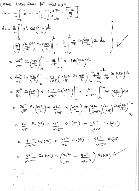

See attached.
Fourier cosine series
I was just going through my old notes on this i.e
The concept is straight forward- only challenge phew :cool: is the integration bit...took me round and round a little bit... that is for ##A_n## part.
My working pretty ok i.e we shall realize the text solution. Kindly find my own working below.
Now to my question supposing we have to find say Fourier cosine series for ##f(x)= x^7##. The integration by parts here will take like forever to do. Do we have software for this? Will Wolfram help?
chwala said:
Will Wolfram help?
Pretty easy to check for yourself :wink: . Let us know !
Will do check @BvU ... however, if one was to do this by hand ... No technology...how long would it take to work to solution?
The ##f(x)= x^7## is odd. Perhaps Fourier sine series rather than cosine?
Set [tex]I_n = \int_0^{2\pi} x^{2n+1} \sin kx\,dx, \qquad k = 1, 2, \dots.[/tex] so that integrating by parts twice, [tex] I_n = - \frac{(2n+1)(2n)}{k^2}I_{n-1} - \frac{(2\pi)^{2n+1}}{k}.[/tex] This recurrence relation can be solved subject to the initial condition [itex]I_0 = -\frac{2\pi}{k}[/itex] to obtain [tex] I_N = \frac{(2N + 1)!(-1)^N}{k^{2N}} \frac{2\pi}{k}\sum_{n=0}^N \frac{(-1)^{n+1}(2\pi k)^{2n}}{(2n+1)!}.[/tex]
