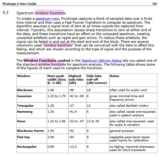

Master1022 said:
I was hoping to gain more insight into these window questions when looking at frequency spectra questions. I don't really know what makes windows better than one another.
Here is some information on various Windowing Functions from the PicoScope USB Oscilloscope Manual (I'm using one right now in one of my test setups at work to do FFTs and frequency domain analysis of powerline communication network waveforms). It's a good brief summary of Windowing functions, and should give you some good search terms for further searching/reading:
https://www.picotech.com/download/manuals/picoscope6-oscilloscope-software-users-guide.pdf
Data analysis types each have their favorites, which means that none of them are the best. They each have their own pros and cons. Ideally, if you care, you will need to analyze the effects of each and pick the best for your particular analysis. The answer lies in being clear about what features of your data set you really care about most.
