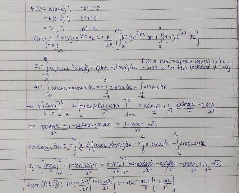

If F(k)= A(a+k) for -a<k<0
= A(a-k) for 0<k<a
= 0 for |x| > a
then calculate ##f(x)=\frac{A}{\sqrt{2π}} \int_{-a}^0 (a+k)e^{-ikx}\,dx + \int_0^a (a-k)e^{ikx}\,dx##
##f(x)=\frac{A}{\sqrt{2π}} \int_-a^0 (a+k)e^{-ikx}\,dx + \int_0^a (a-k)e^{ikx}\,dx##
My Professor has started on the Fourier Transforms Topic in the Introductory Mathematical Physics class and gave us a small homework to try our concepts on.
I have attached a clear & legible snippet of my solution. I request someone to please have a look at it & determine if my solution is correct. (I'd also request some patience since this is my first dabble with the topic).
In the snippet, as described, I took the terms having 'i' as zero from a bit of assumed trickery, using the fact that F(k) had no terms having i as a coefficient so it must be zero in case of f(x) as well. (Not sure if this is correct way).
Then I solved for both integrals separately & added them after plugging in the desired limits.
(Edit 1- I'm fixing up on the Latex commands that I've written, please give a few moments, new to this actually.)
Mentor note: I fixed up the broken LaTeX.

I spot a \, twice, so either you copied the stuff or you are not all that new to ##\LaTeX## ?
Anyway:
\frac{A}{√2π) should be \frac{A}{\sqrt{2π}} (curly bracket and \sqrt{..} instead of the √).
(to see ##\TeX## source, right-click on the formula):
In your " then calculate ##\displaystyle f(x)=\frac{A}{\sqrt{2π}} \left [ \int_{-a}^0 (a+k)e^{-ikx}\,dx + \int_0^a (a-k)e^{ikx}\,dx\right ]## " I don't see why the second exponent is ##+ikx## instead of ##-ikx##
Taking imaginary terms to be zero is not a good idea. Letting them cancel in the end might be good.

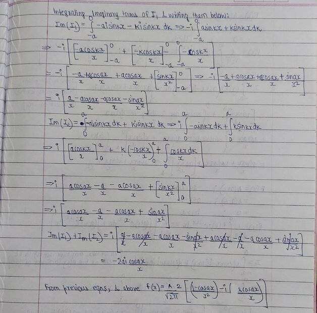

Oh! Thank you loads for noticing this. I think I made the error while noting down the question and continued with it throughout the solution. Will also rectify the imaginary term part so that they cancel rather than the assuming. I'm modifying the solution accordingly..
warhammer said:
It is actually the latter, my first post using Latex. Was typing on my smartphone while viewing instructions from the Latex Help PF Webpage and now shifted to desktop as it was getting tedious.Oh! Thank you loads for noticing this. I think I made the error while noting down the question and continued with it throughout the solution. Will also rectify the imaginary term part so that they cancel rather than the assuming. I'm modifying the solution accordingly..
@BvU As instructed by you, I modified my solution accordingly, continuing from the originally posted image, simultaneously correcting the second term to ##e^{-ikx}## & integrating the Imaginary Terms as well by treating 'i' as constant post expansion after Euler's Formula. Hope it is now devoid of errors..😅

It would take me quite a while to go through that (and #1) and find out what is right and what isn't.
At this moment I don't have that time, so you'll have to check your working all by yourself.
I forgot to correct you in #1 w.r.t. the integration: to get ##f(x)## you integrate over ##k## (which you do in the handwritten stuff).
You have two integral terms $$
\displaystyle f(x)=\frac{A}{\sqrt{2π}} \left [ \int_{-a}^0 (a+k)e^{-ikx}\,dk + \int_0^a (a-k)e^{-ikx}\,dk\right ]
$$and if I had to do this (*), I would try to combine the two to get a real integrand of the form ##A(a-k)\left [ e^{ikx} +e^{-ikx}\right ] ##.
(*) And I had to do this and actually have done this, but unfortunately it's 50 years ago :frown: and I have a hard time reconstructing the steps :smile: .​
Unfortunately:
The reason I expect your result isn't correct comes from knowledge which you are probably not supposed to have available yet:
Your ##F(k)## is a triangle function, which is a convolution of two boxcars ( 7 here). According to 14 ibid (but the convolution in freq ##\rightarrow## product in time domain), I would expect a result looking like ##\displaystyle {\sin^2x\over x^2}##.
