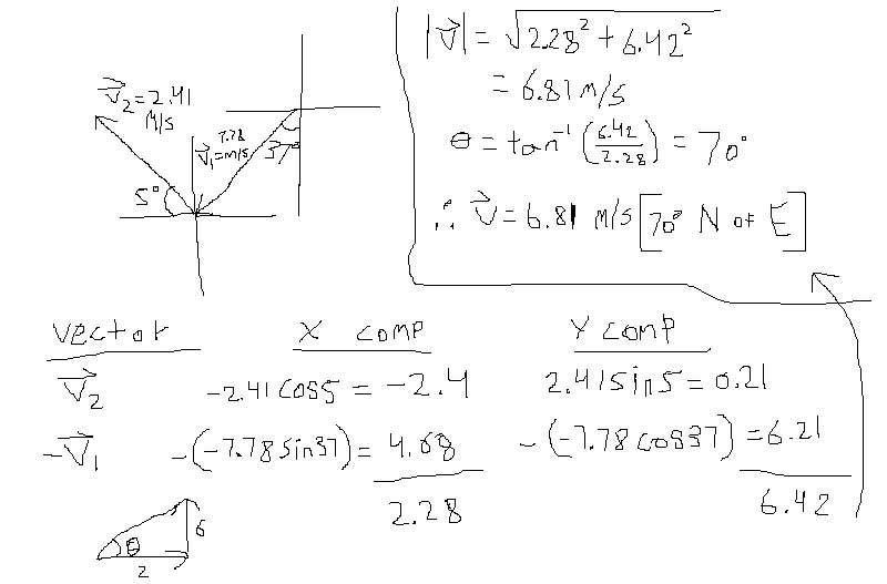

A boat goes at 7.78 m/s [37 degrees west of south] in a current of 2.41 m/s [5 degrees north of west]. Find the velocity compared to the bottom.

I drew a diagram but don't know how to post it here...
You must add the two vectors. They are in different directions, so it is a bit complicated. One method is to find the horizontal (East/west) and the vertical (north/south) components of each vector. Then add the horiz and vertical vectors separately. Sketch these two vectors head-to-tail to add them. You'll see that you need to find the hypotenuse to get the total and use some trig to find the direction.

AWESOME! I know how to do that. I did a lot of those where you add the x and y components to get the resultant displacement or velocity. And yes my diagram is a head-to-tail diagram. Ill do it that way. So the velocity I get will be the velocity compared to the bottom? I'll post my final answer can you check please?

this is how I did it...is this right?
Take another look at your first diagram. It would be a good idea to show the x and y components on there. Both of the x components are in the same direction (left) so you get 2.4 + 4.68 = 7.08 to the left. You may wish to call this -7.08.
In the y direction, the 6.21 is down and the 0.21 up, so you get a total of 6.0 down.
