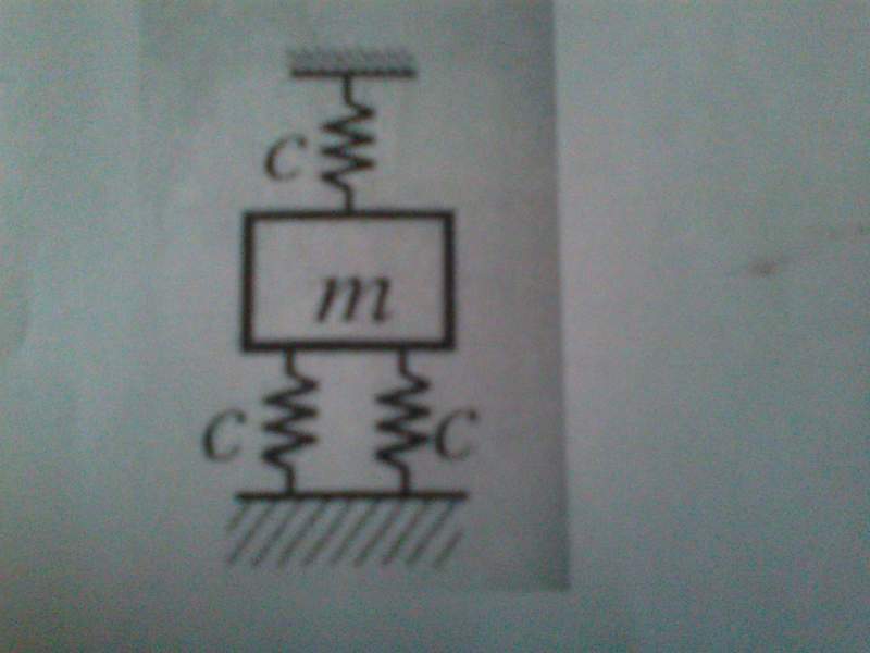

A vertical oscillating system consist of three equal springs with elasticity coefficient c , among which a mass m=2kg is suspended.The system oscillates according to the following law of motion x(t)=0,4 cos 4t+0,5 sin 4t , (m) .
Determine:
1) The equivalent elasticity coefficient ce of reduced spring.

1) The force by a spring is given as F = -kx, where x is the displacement and k is the elasticity coefficient, if you move your mass a small amount what is the net force on it from your three springs?

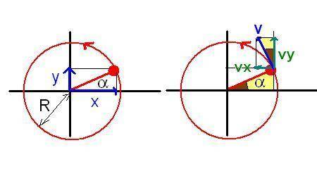

If derivation is not clear to you yet, you certainly was shown that the oscillatory motion can be imagined as projection of uniform circular motion. See picture. A point moves along a circle of radius R with angular velocity ω. At any angular position α, x=Rcos(α) and y=Rsin(α). The velocity V is tangent to the circle, and its magnitude is ωR. The components of the velocity vector are Vx=-Rωsin(α), Vy=Rωcos(α).
It is a uniform circular motion, α=ωt. You can imagine that a function f(t)= Acos(ωt) is the x component of a circular motion along a circle of radius R=A, and the function g(t)=Asin(ωt) is the y component of the same circular motion. That is true also for the velocities, which are equal to the time derivatives of f and g.
f'=Vf = -Aωsin(ωt) and g'=Vg=Aωcos(ωt).
Your function is the sum of one sine and a cosine. The derivatives add up. Can you proceed? ehild

Hi again.My teacher told me everythink is true except elasticity coefficient ce of reduced spring - and Vo for t=0, if the law of motion x(t) is given x(t)=0,4 cos 4t+0,5 sin 4t ...Thanks again.
