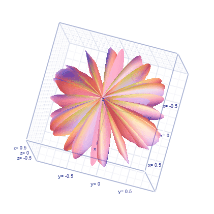

I like Microsoft Mathematics. I used it for Calculus III to help me visualize the concepts and study better. Though I had also forgotten about:
GeoGebra
Which I used in high school for pre-calculus. @Isaac0427 With this one you don't necessarily need to know programming (unlike in my previous post of matplotlib with python). Here you insert your math functions like you write them in paper and with the graphical user interface you modify the looks of it. And you can export your graphs in SVG. You can check it out. :smile:
There are still more tools out there, but I guess with these you can find others if these ones don't cut it. Who knows, maybe another person has used something else they would also recommend. Recommendations are never too much. Well, that's pretty much it.

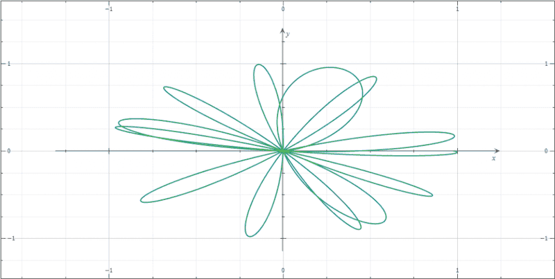

I like it, too, for the purposes of creating plotted images. It's not the most flexible program, but it does it's job nicely. Here's the same basic polar graph in 3-dimmensions and 2-dimmensions:

...Though I can't help but think that the latter one looks squashed. Probably my current settings or something.
I never tried geogebra, but just watched some video tutorials and it seems great! I'd try it yet am deterred by the fact of creating yet another account at yet another site. Perhaps when school starts I'll give it a go, though.

Hihi. I completely agree in that Microsoft Mathematics is not that flexible and requires a little work to fit graphs to a nice scale for display.
As of now you don't necessarily need an account for GeoGebra, at least not for the desktop version of the software :wink:.
