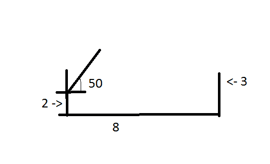

1. Homework Statement
A varsity player is attempting to make a shot. The ball leaves the hands of the player at an angle of 50 degrees to the horizontal at an elevation of 2 meters above the floor. The skillful player makes the shot with the ball traveling precisely through the center of the ring (8 meters from the player and 3 meters above the floor). To loud cheers, calculate the speed at which the ball left the hands of the player. Sketch the problem!
Y=volt-1/2g(t)^2
Voy = Vosintheta
Vox = Vocostheta
Vox = Vocostheta -> 8=Vocos(50degrees) -> Vo=12.446m/s
Then I plug it to X=volt+1/2at^2 a is always 0 right? So it becomes X=volt -> X=12.446(t) -> t=(0.643s)
Then I plug the time to the y equation of free fall.. Delta Y is 1 right? Because 3-2=1
Y=volt-1/2gt -> 1=Vo(0.643)-1/2(9.8)(0.643)^2 Vo=4.7059m/s
y
I'm not sure if my answer is right.. if not can someone guide me...
If it is wrong sorry If I got a wrong answer.. This is why I post in this forums.
Hello VZ, welcome to PF :smile: !
Always a good idea to include dimensions in your calculations -- and to check them. In your case, you go off the rails in the very first line (sorry to say):
## 8 \;{\rm m} = V_{0,x} = V_0 \cos\theta \;{\rm m/s}## can never be right !
Thing to do is write expressions for x(t) = 8 m and y(t) = 3 m, and eliminate t. Best to work with symbols until you have an expression for ##\theta##. Then check the dimensions and do the calculator work.

First - you have equated horizontal velocity to horizontal displacement . This is wrong .
So your second and third equations automatically become wrong .

Consider two unknowns v and t . Obviously v represents velocity of object , and t the time taken to reach the hoop .
What you'll need to do is form two equations . Use the fact that horizontal velocity of object is v*cos(θ) and vertical v*sin(θ) .
Can you manage the two equations ?

SIR I THINK I GOT IT. Okay here goes
ΔX = Vox(t) right? bc a is always 0
ΔX/Vox = t but we know that Vox=VoCos50 and ΔX = 8
so 8/Vocos50 = t
Voy=Vosin50 right?
So
Δy=Voy(t)-1/2g(t)^2
3-2=(Vosin50)(Vocos50)-1/2(9.8)(Vocos50)^2

You need to substitute correctly for t .

No experimenting: you want to manipulate these two equations with two unknowns in such a way that you get one equation with one unknown, namely ##\theta##
The way you write them is confusing -- one Vo with two different meanings, and Vo(t) makes it look as if Vo is a function of t --$$
\Delta X = v_0 \cos\theta\; t \\ \Delta Y = v_0 \sin\theta\; t - {1\over 2} gt^2 $$ is a lot clearer. See also here
