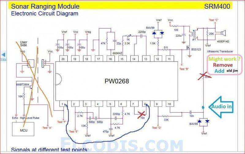

The guys are right - you want to amplitude modulate. Easiest way is just switch it on and off. A 555 timer's discharge pin could short the input to an audio ampilifier. If you use a LM386 it can't make enough power to hurt you.
I see same outfit you're looking at makes this gizmo
http://elcodis.com/parts/2881113/SRM400.html#datasheet
which already pulses the high frequency and that frequency is adjustable.
Have fun, be careful, and start with millliwatts.

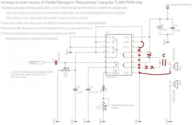

If you`ve heard about a neurophone, you`ll understand...
Interesting !
https://neurophone.wordpress.com/2012/08/05/make-a-diy-flanagan-neurophone-with-a-tl494/
but i'd add a cap in series with transducer and connect both wires...
and set his TL494 for push-pull
see http://www.ti.com/lit/ds/symlink/tl494.pdf
Happy Experimenting !
Likes Sveral and Alpharup
