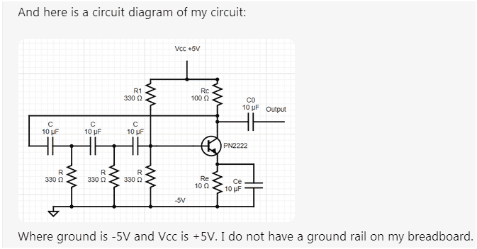

Hello everyone.

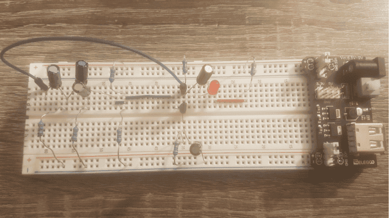

I am having some trouble with an RC phase shift oscillator that I built as a hobby project. I am completely stuck on this and I just cannot figure it out. My oscillator is not oscillating.

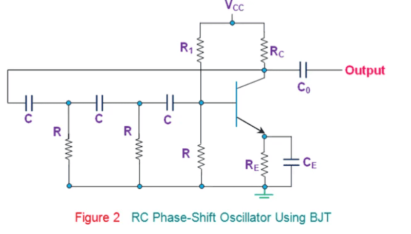

Here is the circuit that I am trying to get to work. Taken from https://www.electrical4u.com/rc-phase-shift-oscillator:
And here is a circuit diagram of my circuit:
Where ground is -5V and Vcc is +5V. I do not have a ground rail on my breadboard.

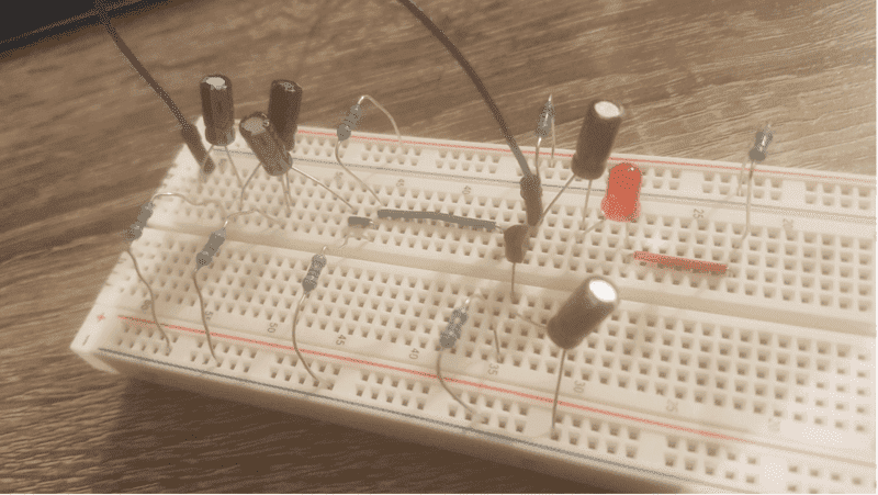

And here is the real circuit:
Where there is a power supply module on the right side of the first image.
Desired frequency
And the frequency that I want is 20 Hz so that I can see an LED flashing:
R = 110 (because the resistors are in parallel)
C = 30 x 10^-6 (because the caps are in parallel)
N = 3
which is about equal to 20 Hz.
Transistor gain
The drop for this circuit is 29, and you need at least a gain of 29 in order for the oscillator to work. My BJT has a minimum gain of 35, so my transistor gain should be good.
What I have tried
- I have quadruple checked that the connections are correct
- I have tried to measure the frequency of the signal at the output, but it gave me 0 Hz
- I have tried to measure the AC voltage of the output and it gives me about 0.7 - 0.8 V (this is a contradictory result to the frequency measurement)
- I have tried to put an LED at the output to see if it flashes, but it doesn't (and I have checked every time after turning on the circuit to make sure that the LED is not burned out)
Please note: this is my very first time building any kind of oscillator.
I have looked at other posts and I saw that some other RC oscillators do not have enough voltage to sustain the oscillations. I am not sure if my circuit has the same issue.
I didn't really know what values the compoents should have as I have not seen any good examples online. Maybe you could provide some examples?
Thank you.

The usual problem with RC oscillators in not enough gain. I notice you have a low value of collector load. Remember this is in parallel with the phase shift network - have you allowed for this? I would be inclined to try a higher value of collector load, such as 1k, and possibly a different transistor.
The transistor biasing looks wrong to me at first glance. Your objective should be to get the quiescent Vc collector voltage to be about half-way between the rails (so near 0V in your case). You set that operating point with the base voltage generating an emitter current through the emitter degeneration resistor Re (ignore the emitter capacitor Ce for the DC bias point). Right now it looks like the voltage across Re will be a bit over 4V, so 400mA of current for Ic and Ie? That will try to give you a 40V drop across Rc, which cannot happen of course.
Instead, bias the base of the transistor closer to the lower rail, so you drop about a volt across Re and Vc ends up around 0V with whatever Rc values is needed at that bias current. I also think your Ce value will need to be larger if you want good gain at only 20Hz...

I suspect the RC timing components are too low an impedance compared to the amplifier circuit.
I would change the three 10 uF timing capacitors to 0.1 uF, and change the three 330R timing resistors and R1 to 33k.

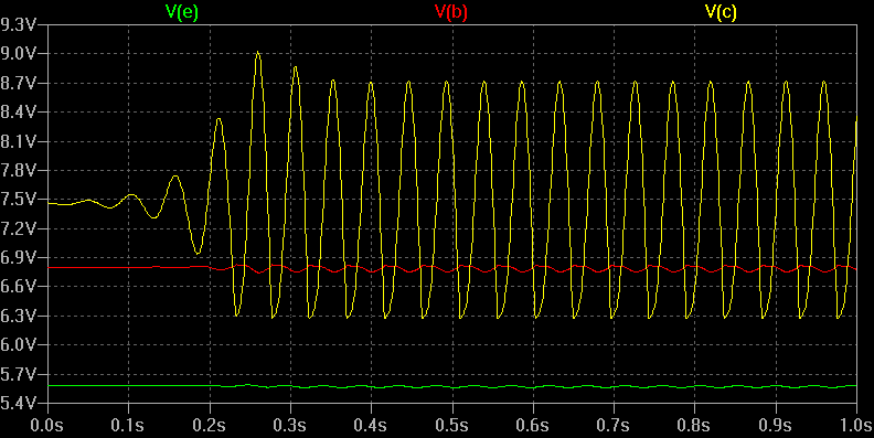

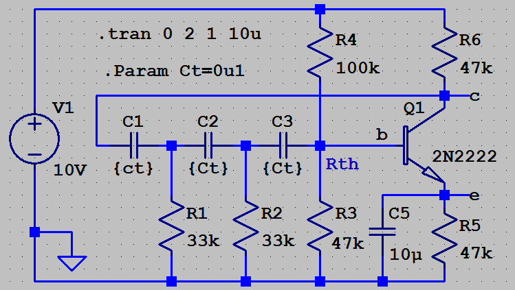

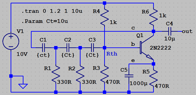

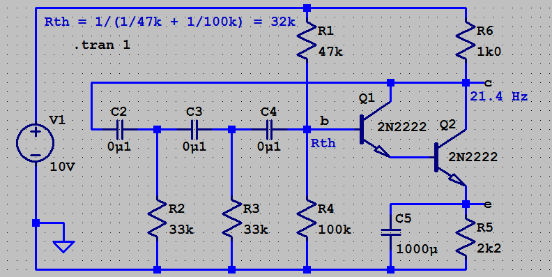

Have you tried changing to the circuit that @Baluncore simulated yet? That would be your best bet right not to get it working, IMO. :smile:

Yes. But the collector output must be able to drive the three high-pass filter stages.
It is good to avoid electrolytic capacitors because their life is limited and small capacitors are cheaper. Bigger resistors and smaller capacitors have less signal current, so the circuit uses less power, but has the same time constant.
RC = 330R * 10uF = 3.3 msec
3k3 * 1uF = 3.3 msec
33k * 0u1F = 3.3 msec
330k * 10nF = 3.3 msec
Circuits with resistors over 100k because less stable because surface leakage currents due to dirt and moisture begin to affect the circuit timing.
The limitation is that the circuit will not oscillate if the output is overloaded, which lowers the gain.
I needed to make several sequential changes to the circuit until I got the oscillation. For example, the emitter resistor sets the transistor bias current, while the emitter capacitor increases the AC gain. The time constant of R5*C5 must be great compared with the period of the signal. That is why such a long TC needs a massive capacitor.
My aim was get it to oscillate. I could recalculate ideal component values, but I do not know the purpose of the design so can't guess what would be optimum. I do not think you will use this circuit for your oscillator.
I don't have those kinds of component values. I would have to buy some. Or I could go with a different frequency altogether with components that I do have.

I found out that I am just biasing my transistor incorrectly. I looked at some examples online and saw that I was doing it incorrectly. I will figure out how to bias it properly.

So if resistors over 100k make the circuit less stable, does that mean that the smaller the resistor is, the more stable it will be? Surely there is a minimum resistor value that allows for maximum oscillator stability. Does this only apply to this RC circuit or to all circuits in general?
But the oscillator must oscillate.
The gain of the transistor rises in proportion to the collector load resistance.
The RC timing circuit is connected to the collector so it lowers the gain.
Use the highest timing resistor values within reason, to get a gain greater than unity.
If the gain of the circuit falls below 1.000000 at the frequency you expect oscillation, the oscillator will not oscillate, it will be very stable, and dead.

Which is why the early suggestions (and @Baluncore's circuit) suggested higher gain transistors. The input impedance of BJTs (especially at 20Hz) doesn't have to be low. It's just the emitter load times β+1. You get to choose this as well as the impedance of the feedback network. BJTs are fine for this circuit, but it has to be designed correctly.
