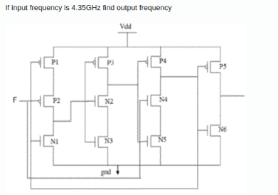

If input frequency is 4.35 GHz, what is output frequency
CMOS inverter theory. If Nmos has high gate voltage then Nmos conducts but if Pmos has high gate voltage, it turns off

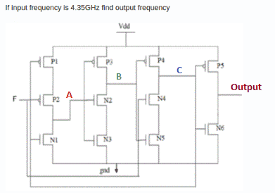

I made a table using excel as:
245656
D is output. Like this I get Output frequency is same as input frequency. But I'm not sure if this is correct.

You seem to be missing the multiple inputs to each stage:
A depends on F and on C, C depends on B and on F.
I think you need to work out what the logic table is for these two (A, C) before you work out your table for A, B, C, D.

You also need to note that this is a dynamic mos circuit, where gates can be neither high nor low (open circuit output) and the input to the next stage remains at its previous value, by retention of static charge on the gate.

For logic table A = not(C) * not(F) not means inverted. * means 'and' gate
B = not(A)
C = not(F)
Output = not(C)
What do 'gates be neither high nor low' mean?
Say C was high and F was low, then N1 and P2 are off. P1 is on, but in series with P2 which is off. So the output A is open circuit, not connected to high nor to low. So A does not alter the gates of P3, N2 and N3. They hold their existing state (temporarily) due to the capacitance of their gate.
So the logic rule you gave, A=Not(C) And Not(F) is not necessarily correct when C=1 and F=0.

Thanks for the guidance and help. The question is very difficult and exhausting. I'll try to implement it in Cadence to find the waveform and frequency.
