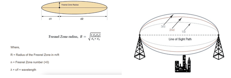

Left: diagram of an elongated ellipse with d1 and d2 marked along its base and a Fresnel Zone Radius line. Below it, the formula R = sqrt(n d1 d2 lambda / (d1 + d2)) with variable definitions. Right: two towers joined by a line of sight path, with ellipsoidal 1st, 2nd and 3rd Fresnel zones around it and a city skyline below.

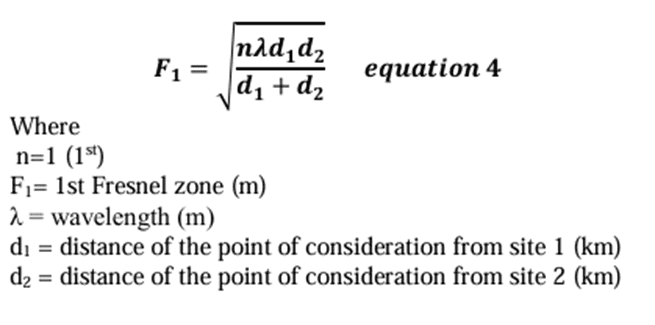

Because the website didn't tell the unit of the distance and wavelength (I know the SI unit is meters, but still, incomplete equation without telling the unit can make confuse since there are a lot of conversion of unit), so I search another source, I found in this article Utilization of Trendlines in Determining Antenna Heights for Microwave Communications, and the equation is
Equation 4: F1 equals the square root of (n λ d1 d2 divided by (d1 + d2)), with n = 1, followed by variable definitions for F1, λ, d1 and d2.

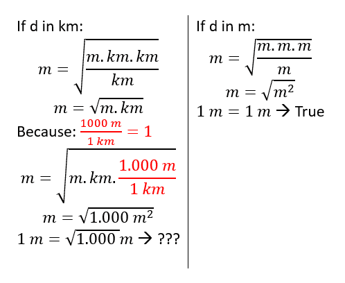

For making sure, I check the dimension for both the left and right side, but using the unit instead of the real dimension, it turns out to be false if the distance is in km unit.
Handwritten unit-check of m = sqrt(m.km.km/km) in two columns: left for d in km, showing m = sqrt(m.km), then a red factor 1000 m / 1 km inserted, giving m = sqrt(1.000 m^2) and 1 m = sqrt(1.000) m with ???; right for d in m, showing m = sqrt(m^2) and 1 m = 1 m, marked True.
From this step, I'm surely use d in unit meters cause the general equations only true if d in meters.

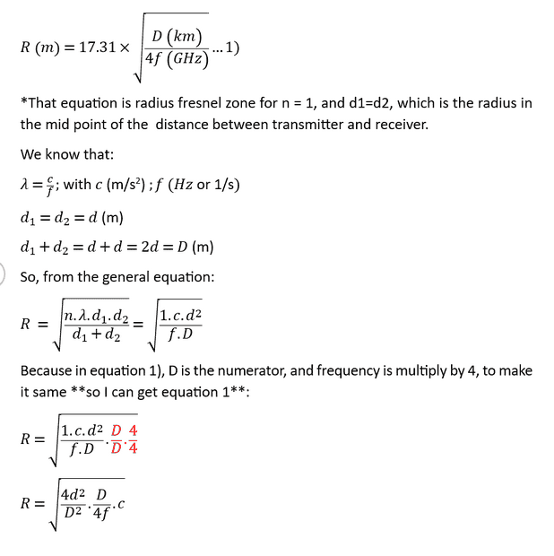

Next, i want to know how to obtain equation 1) from the general equation. So, I did this:
Handwritten-style derivation: equation 1) R (m) = 17.31 x sqrt(D (km) / (4f (GHz))), then d1 = d2 = d, D = 2d, and a step rewriting R as sqrt(4d^2 D / (D^2 4f) c), with red highlights on D and 4.

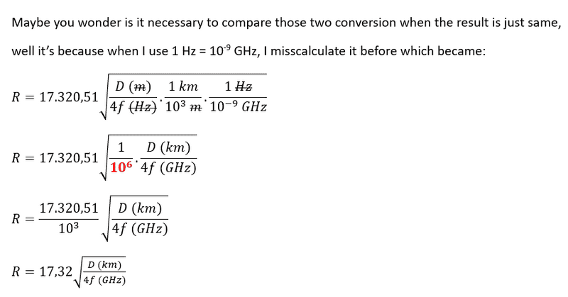

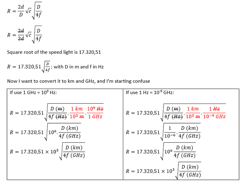

Handwritten derivation converting R = 17.320,51 sqrt(D/4f), D in m and f in Hz, to km and GHz units, with unit cancellations struck through in red and two parallel results shown.
Handwritten unit-conversion working showing R = 17.320,51 times a square root of D (m) over 4f (Hz) with 1 km/10^3 m and 1 Hz/10^-9 GHz factors, then simplified forms ending in R = 17,32 times the square root of D (km) over 4f (GHz).
The red bold is when I miss calculate it, so I was happy when I thought I reach my goal to obtain the same equation
So yeah, it become different with equation 1), if it should be same, it must 17.320,51 divided by 1.000, but when I calculate, it multiplies them. Please help me find my mistake calculating this equation.

Your mistake is not keeping track of units for the number you say is the square root of the speed of light.

Perhaps the typo in the first image (below) is creating some confusion?
Text reading 'Where,' followed by 'R = Radius of the Fresnel Zone in m/ft' on a white background.

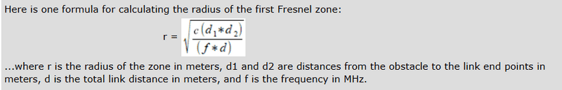

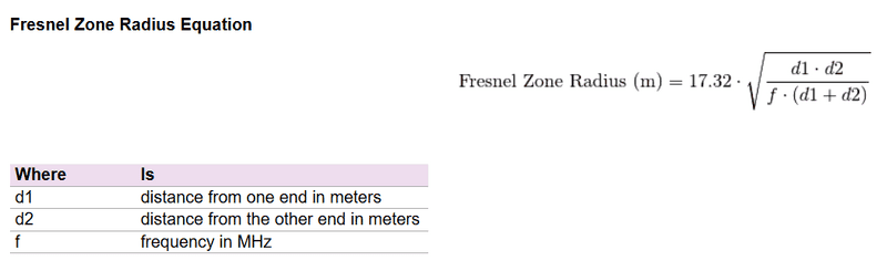

In here: [1] and [2], both the frequency is in MHz unit
Source: [1]
Table-style slide titled Fresnel Zone Radius Equation showing Fresnel Zone Radius (m) = 17.32 times the square root of d1 times d2 over f times (d1 + d2), with a key defining d1 and d2 as distances in meters from each end and f as frequency in MHz.
Source: [2]
Text reading: Here is one formula for calculating the radius of the first Fresnel zone: r = square root of c(d1*d2)/(f*d), where r is the zone radius in meters, d1 and d2 are distances from the obstacle to the link end points, d is the total link distance, and f is frequency in MHz.

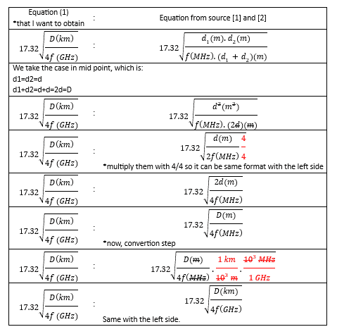

I calculate to check both the right and left side, it turns out that they just same.
Table comparing Fresnel zone equations: Equation (1) 17.32 sqrt(D(km)/(4f(GHz))) against source equation 17.32 sqrt(d1(m)d2(m)/(f(MHz)(d1+d2)(m))), with substitutions d1=d2=d, unit conversion steps and red strikethroughs showing km to m and GHz to MHz.
I'm still confuse 'cause I can't find the way to obtain Equation (1) from general equation whose had n parameter. There's additional 1.000 that should multiply with 17.32, when in every fresnel zone equation that I see, there's no 1.000
well, it could be.. cause the website give unclear unit that should be use

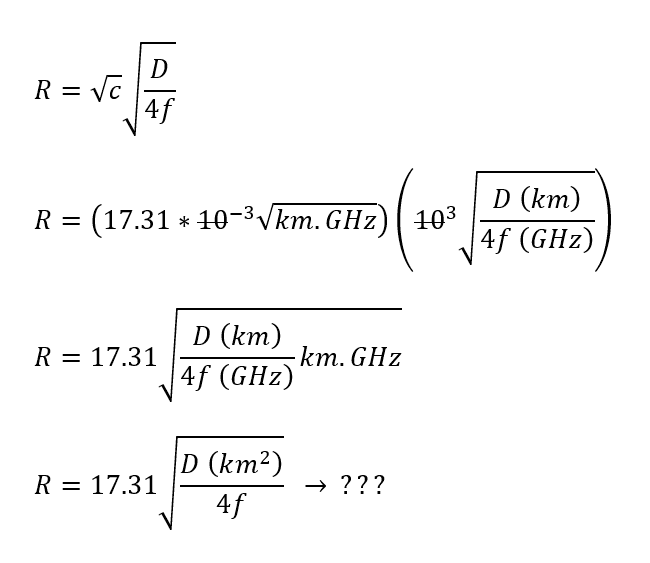

ohh, thanks Haborix, I used the wrong unit for c with m/s^2, but please, I'm stuck again :(((
Handwritten-style derivation of the Fresnel zone radius R = sqrt(c) sqrt(D/4f), rewritten with units: R = 17.31 sqrt(D (km)/(4f (GHz))) km.GHz, ending with R = 17.31 sqrt(D (km^2)/4f) followed by question marks.
Isn't that what you wanted to show? Part of the problem here that makes this confusing is the substitution of numerical values for some constants while leaving variables in the equation. That's not your fault, it must just be the practice in this area of technology.
The consequences of that are pretty scary. In the same way, relying on simulations is also dangerous. Science has only advanced because people stopped just using measured or observed numbers and used symbols to describe the patterns of how things behave. It's a real cop-out to avoid the Maths and to use 'magic numbers'.
