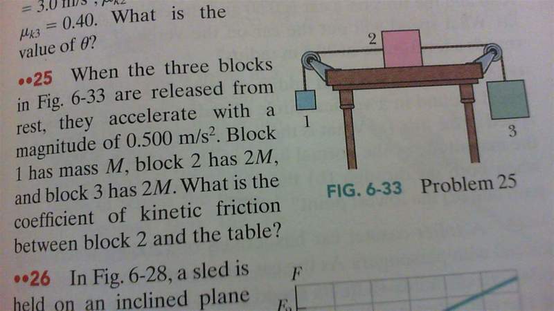

It's attached.
F = m*a
F_f = -μ_k*F_N // [Force of friction] = μ_k*[Normal force]
So, I think I managed to solve it -- at least, I got what the book got, but I don't understand part of what I did to get the answer.
This is how I solved it and got the answer the book got:
I drew a free-body diagram, and realized that F_n = 2Mg
Which means F_f = -μ_k*2Mg, Block 2 is being pulled by an effective force to the right of Mg (Since -Mg + 2Mg = Mg).
So the summation of all the forces in the x direction would be:
***: Mg + F_f = Mg - μ_k*2Mg = (5*M)a
Plugging in for a and other known values and some algebra later, I get μ_k = 0.37
And that's the answer the book gives.
My question is why is it m = 5M in Newton's second law (the *** equation). When I first tried to solve it I used the mass of the 2nd block (m = 2M) and I thought that was correct.. apparently not.
Please explain this to me. Thanks in advance!

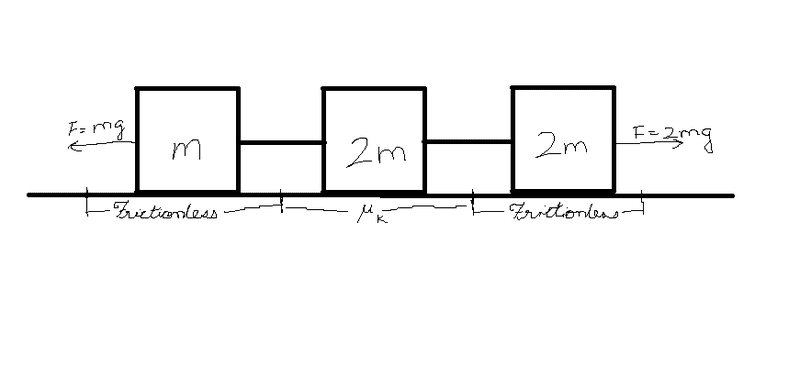

think of it in a linear manner (see attached file). You will probably understand it now.
The equation relates the total force on the system of the three blocks to their acceleration. If you take m=2M that would be considering only the force on the block of mass 2M, and its force equation would be different(involving tensions in string, etc). The 5M is for the system of all the three blocks taken together.
Normally i calculate for each mass.
Check where the direction of acceleration
1.(3M)-
3Mg - F1=3Ma
2 (2M)
F1-F3-friction=2Ma
3. (M)
F3-Mg=Ma
(1)+(2) +(3)
3Mg-Mg-friction =6Ma
net force=ma(Newton 2nd Law)

I think your 3M is a mistake (it's 1M, 2M, 2M), but I understand what you're saying.
Oh. So it always ends up as a linear system of equations with n equations n unknowns (where n is the # of bodies), so I can use matrices! The other unknowns in this case would be the two tensions, what you called F1 and F2.
Thanks for helping me generalize the solution to the problem.
