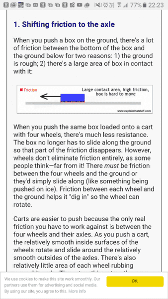

It's becoming clearer to me now. But on this other website they mention "large contact area, high friction, box is hard to move". Does that mean the website is wrong?
Yes it is Wrong... Which website is this?
Try more Fundamental Books of Physics.
It's Leonardo da Vinci who discovered Laws of Friction.
And the Most Fundamental quality is that Friction is independent on Area.
