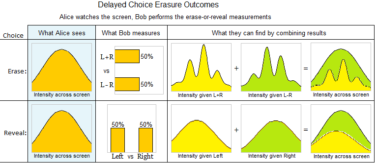

Table of delayed choice erasure outcomes in two rows, Erase and Reveal, with columns for what Alice sees, what Bob measures, and combined results; Alice's screen intensity is a single smooth bell curve in both rows.

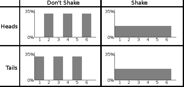

See also: "A Classical Delayed Choice Experiment" http://algassert.com/post/1720 , which makes it a bit clearer what the mistake you're making is:
Four small line graphs labelled R01 to R04: R01 has a multi-peaked curve, R02 a curve with a tall peak and smaller side peaks, R03 a single broad hump, and R04 a red smooth single hump marked supplied.
Four bar charts in a 2x2 grid, columns labelled Don't Shake and Shake, rows labelled Heads and Tails, each with a 0% to 35% y-axis and outcomes 1 to 6 on the x-axis. Don't Shake Heads shows bars at 2, 4 and 6; Don't Shake Tails at 1, 3 and 5; Shake Heads and Shake Tails show flat bars across all six outcomes at a lower height.
  • Table of delayed choice erasure outcomes in two rows, Erase and Reveal, with columns for what Alice sees, what Bob measures, and combined results; Alice's screen intensity is a single smooth bell curve in both rows.
  • Four bar charts in a 2x2 grid, columns labelled Don't Shake and Shake, rows labelled Heads and Tails, each with a 0% to 35% y-axis and outcomes 1 to 6 on the x-axis. Don't Shake Heads shows bars at 2, 4 and 6; Don't Shake Tails at 1, 3 and 5; Shake Heads and Shake Tails show flat bars across all six outcomes at a lower height.
