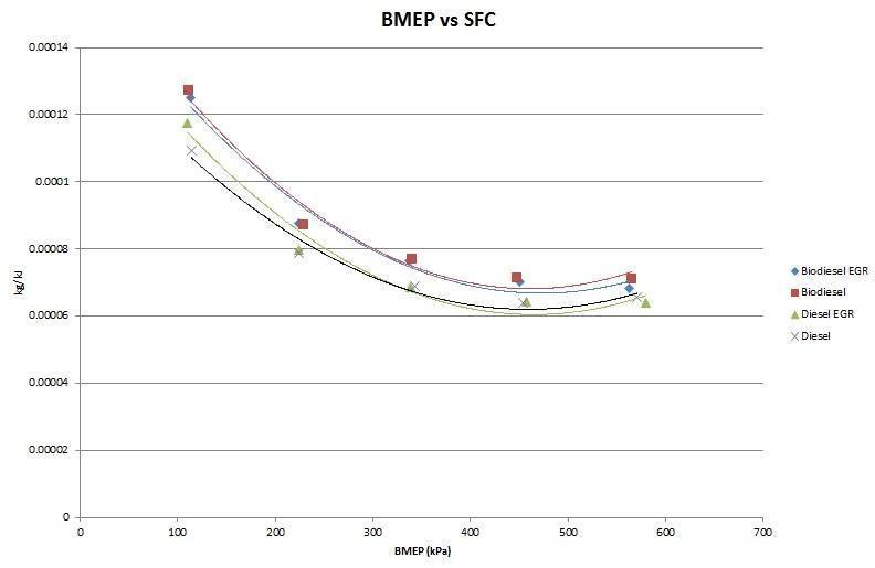

The answer has been given here already, but as a little addition it is worth noting that VERY low loads can cause poorer specific fuel consumption due to immense pumping losses experienced due to an almost completely closed butterfly valve on the throttle. Though in this example I'm sure this doesn't need to be taken into account as traveling along at 2000RPM in either 3rd or 4th gear should provide ample butterfly valve opening for this phenomena to be irreverent. I have attached a little JPEG of an experiment I performed recently demonstrating this effect.
Actually, the pumping loss is most extreme at this engine speed in a lightly loaded cruise mode- it's ALL about throttle angle- so if both were at WOT up hill the loss would be insignificant. If you were to take a vacuum gauge and run it at idle then at 2,000, I think you will see what I mean.
At 2k only the load will be different for this test- they will both use very nearly the same amount of fuel, with the 4th gear engine using slightly more.

Did you check the picture I posted? Clearly, pumping losses are NOT at the most extreme at mid-cruising load, throttle angle is further reduced at zero load under tickover situations, therefore pumping losses are the most extreme here.

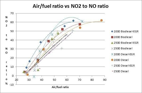

Yet another test on an older diesel engine with direct injection and no throttle valve. Note how NO and NOx production increases as air to fuel ratio becomes more LEAN.
Really, all I have heard so far is how your experience as a technician for 35 years is a far more valid proof than any actual data collected in the real world with scientific tests.
Appologies, that was poorly written. I was trying to demonstrate how NO2 production is increased in comparisson to NO production at higher loads due to the more abundant amount of oxygen present when the engine is leaning further. I have a BMEP vs NOx specific results but these are more likely explained due to higher combustion temperatures (I have included them anyway). The main point, however, is compression ignition engines do run lean.

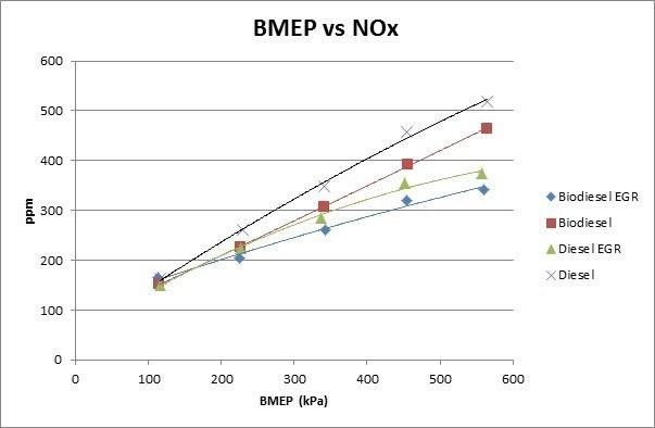

Saying CI engines run lean is a generalisation and just doesn't apply to all conditions. I would be very interested to see your data purportedly showing increased nitrogen oxides formation with increasing air fuel ratio under load, and the operating conditions this was observed under.
If a generalisation, would you not agree it is at least usually true in most situations? Would you also agree it's more accurate than suggesting compression ignition engines cannot run lean at all? I'm unsure what data you would like to see, perhaps you could tell me what data you would like to see plotted against each other and I could do so, I'd be glad to do so.
Sure, I agree with your general comments, but not the generalisation.
I would like to see your plot of exhaust NOx concentration against AFR for a constant BMEP. I would be surprised to see NOx increasing with increasing AFR; and if this is the case, I would be keen to understand the circumstances around this.

Great paper! I've read that one recently, let me quote a few things from it for you;
"NOx emissions are associated with high gas temperatures and fuel lean
conditions and, in contrast to most other pollutants, are usually observed to increase when
biodiesel is used [4]."
"While the bound oxygen on the biodiesel molecule may play a role in leaning the air-fuel ratio in NOx formation regions, the dominant mechanism seems to be the effect of changes in the physical properties of biodiesel, such as the speed of sound and bulk modulus, on the fuel injection timing [5]."
Seems they mention 'lean' quite a few times in regard to compression ignition engines. So if that was your point, thanks for correcting yourself! Without balancing the chemical equation for a generic diesel fuel the stoichiometric point is (roughly) 20-25:1 and anything higher than that is lean, the fact fuel isn't pre-mixed in a manner akin to that of a spark ignition engine does NOT factor into this. Air to fuel ratio is very simply calculated from mass flow rate of air divided by the mass flow rate of fuel, hence compression ignition engines (generally) run lean.
Soot formation is associated with rich burn along with increased CO emission, NOx is associated with lean burn due to (as you correctly mention) higher combustion temperatures and flame propigation rates, these are two EFFECTS from running lean or rich.

I don't have any data with a constant BMEP across the same fuel type as A/F was changed due to experiments being conducted under different loads therefore altering the BMEP. I can plot NO or NOx (or both) against a BMEP value that isn't constant and provide the A/F ratio of each point? I don't know if that is of any use to you. I think the increasing NOx values with a further leaning charge is caused by higher combustion temperature, I can provide data for exhaust gas temperatures bellow the exhaust manifold for all data, again if that's of any use to you.
