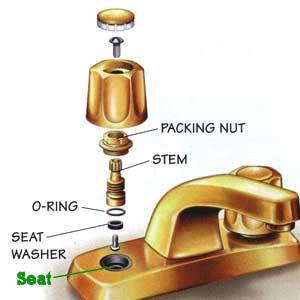

looks like that nut just below the removable stop screws the whole valve stem out.
http://www.doityourself.com/icat/kholersterlhotstem
  • #36
So, more torque then? Hmm... I'm going to need another beer first.

it's what I would do, but I'm taking no responsibility for it. please turn off the supply first.
i honestly don't see how you'd get much torque out of a nut-driver either, unless you've got a grip that makes pro wrestlers wince.and who knows, maybe the thread is lefty?

Faucets will occasionally drip because there is a small piece of debris or grit that comes through the water line and sticks in the washer.
It will even happen in a cartridge type stems because they still have O rings that make the seal.
Turning the faucet to full on then off a few times very often stops the drip.
As a last resort only: Sometimes a stem or even a bolt that is frozen can be broken loose by turning it in both directions slightly until you can feel movement.

Yes, that's the approach I took. It's still partially disassembled, but I'm not doing anything more with it.
