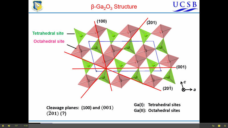

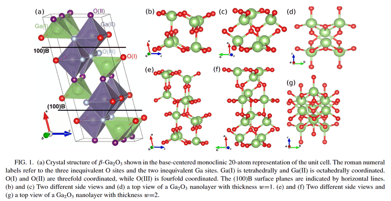

I have three questions regarding the material Gallium Oxide. I was reading in several articles and they introduced its structure as it has monoclinic structure and it consists tetrahedral and octahedral structures in it. What I can't understand I can connect this structure to the chemical formula: Ga2O3... because in octahedral or tetrahedral the gallium is bonded to 4 or 6 oxygen atoms.
My second question is: how the plane 100 or 001 in the pictures below is crossing the unit cell I can't read this actually?
My last question is regarding the material, that it is a n-type semiconductor... Why it should be n-type if all the oxygen atoms are bonded with gallium atoms? why should be free electrons in the conduction band even there is no doping?!The first image is from the article: https://journals.aps.org/prb/pdf/10.1103/PhysRevB.96.081409
As you can see in the first figure, the structure is not actually trivial. However, you can relate it to the chemical formula just by counting the atoms in the unit cell. Every atom that is completely within the unit call counts as a full atom. An atom on a surface plane counts as half an atom (since it contributes to two different unit cells). An atom on a surface line counts as a quarter of an atom (since it contributes to four different unit cells) and an atom located at a corner counts as 1/8th of an atom (since it contributes to 8 unit cells).
It might be a bit tedious to actually do the counting in the unit cell in the figure, but when done right, you will find 12 Gallium atoms and 18 Oxygen atoms in total which matches the chemical formula.
These are the surfaces that form when you cleave the material. The (100)B plane is literally the plane that forms when you cleave the crystal by "removing" the bonds between Ga(II) and O(III). So this is the surface you get when removing all the bonds that cross the line in the figure.
