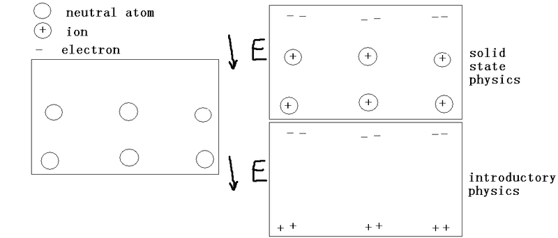

The left pic is the initial state and the right pics are 2 different descriptions for a metal under electric field E. Are the 2 on the right contradictory and which is correct?

The bottom pic can be seen in any introductory physics textbook. The top is drawn by myself, no reference.
That's not very helpful I'm afraid. What motivated you to draw the bottom picture? What equations are you assuming while making the drawings?

The bottom pic means that electrons are pushed by E to the top, leaving the bottom boundary carrying positive charge. Equations can be coulomb forces.

Ok, so you drew the top left picture labeled "solid state physics" yourself. Can you explain how, according to that picture, the electric field inside the conductor is zero? In the "introductory physics" picture, it's easy. The positive and negative charges are on the surface of the conductor. The negative charges "stop" the electric field lines at one surface and "start" them at the other. This does not seem to be the case in the "solid state" picture. If one draws a Gaussian surface around the positive charges, there will be net electric flux out of it which means there is an electric field inside the conductor under static conditions. That is turn means that the conductor is not an equipotential.

I thought of what you say and totally agree all along. But the ions in the middle of a solid should be fixed in place so where can they go?

Yes, the positive ions are indeed fixed but the electrons are not. Electrons will be attracted to the fixed positive ions and neutralize them. In the "solid state" drawing the row in the middle should have neutral atoms, not charged ions.

Gauss' law will require this to happen. But from the opinion of force analysis, why would electrons be attracted to the ions in the middle and end up staying there rather than driven by E all the way to the top boundary?

Electrons move in response to external electric fields. The electric field inside the conductor is the vector sum of the external electric field ##\vec E_{ext.}## and the induced field ##\vec E_{ind.}## that is produced by the movement of electrons to the surface. These two fields cancel each other inside the conductor. The cancellation occurs because the free electrons will move and keep on moving until they have no more reason to move which happens when the field everywhere inside the conductor goes to zero. The solid state physics drawing that you drew has positive ions inside the conductor which means that there is a non-zero field in their vicinity. Therefore electrons will move to neutralize these as well as any other positive ions inside the surface of the conductor. This leaves positive ions only on the surface.
The ions in the middle want to absorb the electrons, but what if E successfully drives the electrons upwards with a larger force without letting them reach and neutralize the ions in the middle?

I drew only a few ions for illustration, not accurate.

(3) You keep groping towards the century-discredited Drude model, where electrons behave as a classical gas. As we said in your last thread on this, a classical theory of electromagnetism, where charge is treated as a continuous fluid will work (in its domain of validity). A quantum-mechanical treatment of electrons will work. Mixing the two, as you are trying to do, will not work. A classical treatment of electrons, inherently a quantum mechanical object, cannot give the right answer.
