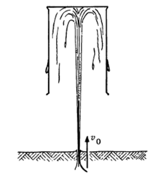

An inverted garbage can of weight W is suspended in air by water from a geyser. The water shoots up the ground with speed ##v_0##, at a constant rate ##dm/dt##. The problem is to find the maximum height at which garbage can rides. What assumption must be fulfilled for the maximum height to be reached.
Ans. clue. If ##v_0=20\, m/s##, W=10kg, dm/dt=0.5 kg/s, then ##h_{max} \approx 17 \, m##
I don't know how to begin with this problem. I think that I have to find the force due to water but I can't see how to form the equations here. I need a few hints to begin with.
Any help is appreciated. Thanks!

Does the momentum of the water change when it interacts with the can? Can you solve the problem if there were balls shot up instead of water?

Yes, the momentum of water changes. If the base of garbage can is at a height h, the velocity with which water strikes is ##\sqrt{v_0^2-2gh}##. The problem is how do I find the change in momentum of mass of water striking the can. The question doesn't state the type of collision between water and can.

Yes, when is it maximum? At elastic or inelastic collision?
ehild
ehild
Elastic.
Does it mean the water bounces back with ##\sqrt{v_0^2-2gh}##? I guess that would be wrong because the garbage can is also moving. Correct?

Yep, so what are you missing? What does the water do?

Change in momentum of water at maximum height is ##2\Delta m\sqrt{v_0^2-2gh}##. The force applied on can in time ##\Delta t## is ##2(\Delta m/\Delta t)\sqrt{v_0^2-2gh}##. Taking the limit ##\Delta t\rightarrow 0##, the force acting on can is ##2(dm/dt)\sqrt{v_0^2-2gh}##. This is balanced by the weight of can. Hence,
$$2\frac{dm}{dt}\sqrt{v_0^2-2gh}=W$$
From here I can solve for h.
Looks correct?

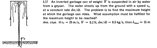

In the 2010 edition, the answer clue is ## v_0 = 20 \ \text{m/s}, \ W = 8.2 \ \text{N}, \ dm/dt = 0.5 \ \text{kg/s}, \ h_{\text{max}} \approx 15 \ \text{m} ##.

Mine is a low priced Indian edition 2009.
The text as you gave it is an exact copy from the original 1973 edition.
I have checked my text again, I have copied down the same exact wordings.
Check this book on Google Books, this is the one sold in my country:

Yes. :smile:

I cannot seem to be able to look inside, but I think this is just a reprint of the original edition, with all of its errors.
Also, the clue you posted doesn't satisfy the result I reach. I have tried both values of g i.e 9.8 and 10.
I agree there is still a discrepancy, but at least now the statement of the problem is consistent.

That's still wrong. 8.2 Newtons is the weight that can be suspended at 17 meters. It's about 15 meters for the 10 Newton garbage can.
Yes, that was already pointed out and it is exactly 15 meters if g=10 m/s^2 is used. :)
