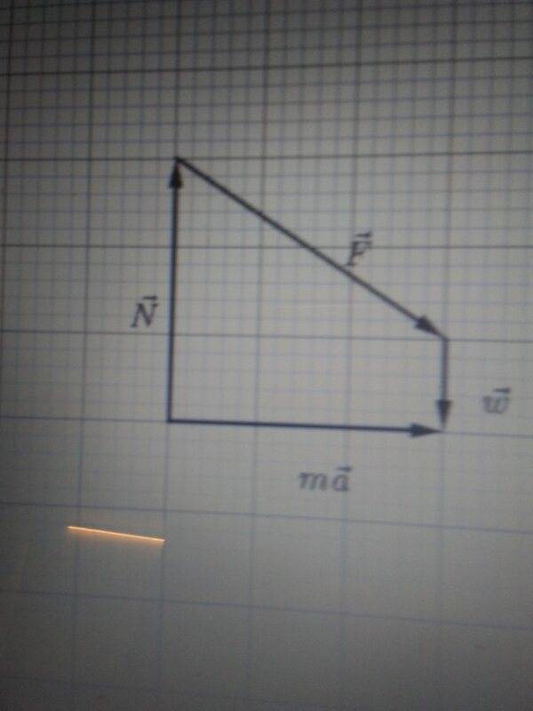

d) No images found. As the level required is lowly (access to university) I've drawn the forklift like a free-body diagram, with three vectors: normal, weight, and forty degrees upwards force... does it make sense?
a) w=mg=802 N.
b)##N=w-F\cdot{sin{(\theta)}}=762\;N##
c)##F_x=m\cdot{a_x}##; ##65\;N\cdot{\cos{(40)}}=82\;kg\cdot{a_x}##; ##a_x=0,61\;m/s^2##
Regards
Yes.

Your diagram seems a bit not-to-scale. The force ##F## is only 65 N, but it appears much larger than the weight.

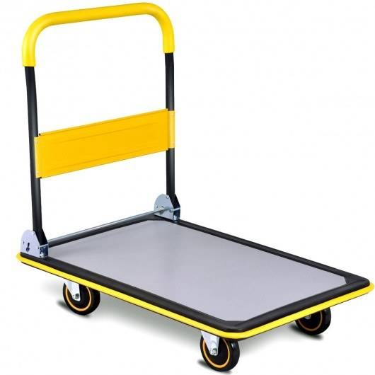

It seems to me that the problem can't refer to a wheelbarrow, because we run into the problem of the lever effect and it does not give you any information about distances among hands, load and wheel.
Let's assume that the word "carretilla" refers to a push cart dolly instead.
The word "asa", previously translated as forklift, should become handlebar.
The word forklift should become handlebar.
That makes more sense.

In this particular problem, the handlebar is not perpendicular to the platform, but it forms an angle of 40° with respect to it (sorry, I could not find a suitable picture).
The gardener pushes with 65 N along that handlebar (same 40° respect to horizontal).
